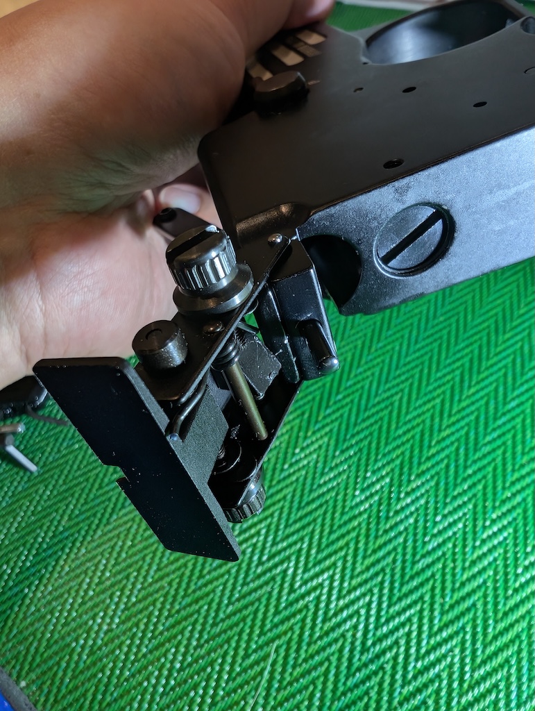

A new shooter pushed on it and it just came up against the pivot.. what should I do? Forcing it back in doesn't seem to be the right thing to do..
Fixing a pardini sight

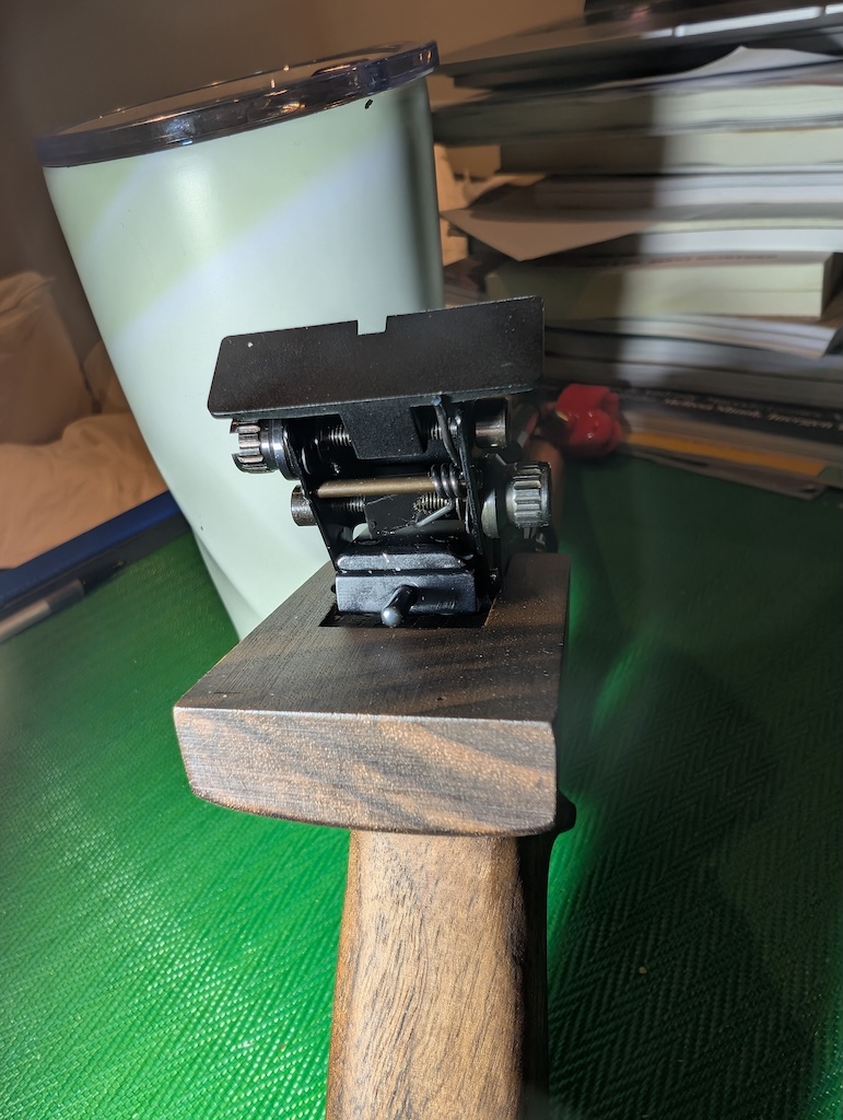

Had the same thing happen to me. Remove the grip and put the pin back under the spring. Takes some finagling to get it back in but I was able to get it without too much trouble.

Take the sight off. A tiny screwdriver can be useful to force the spring a little when you slide it on to the pin. Just a little bit, and then you can easily push the sight forward on the pistol and put the pivot pin back in.
Pivotpin is not tapered, goes any direction.
