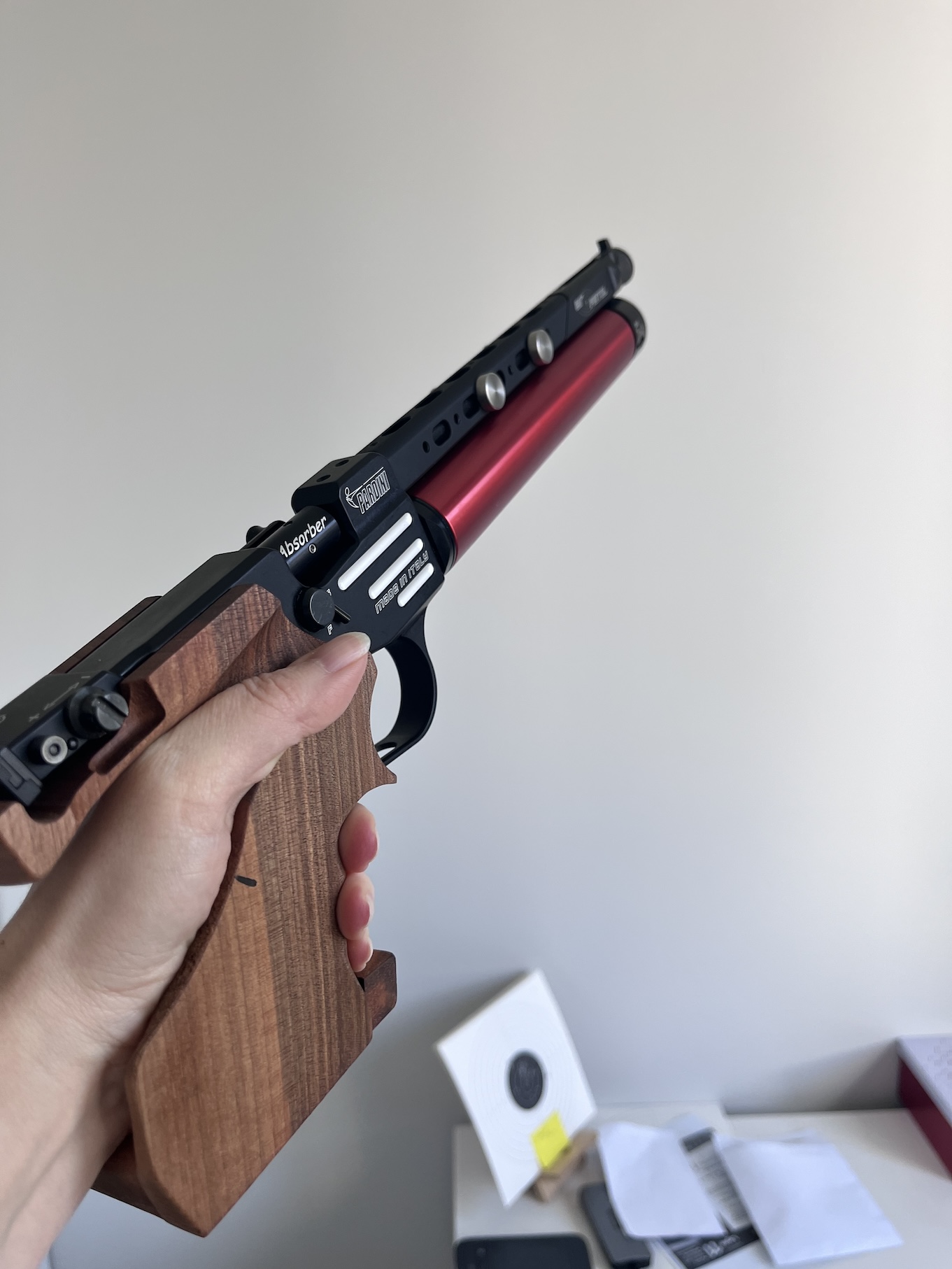

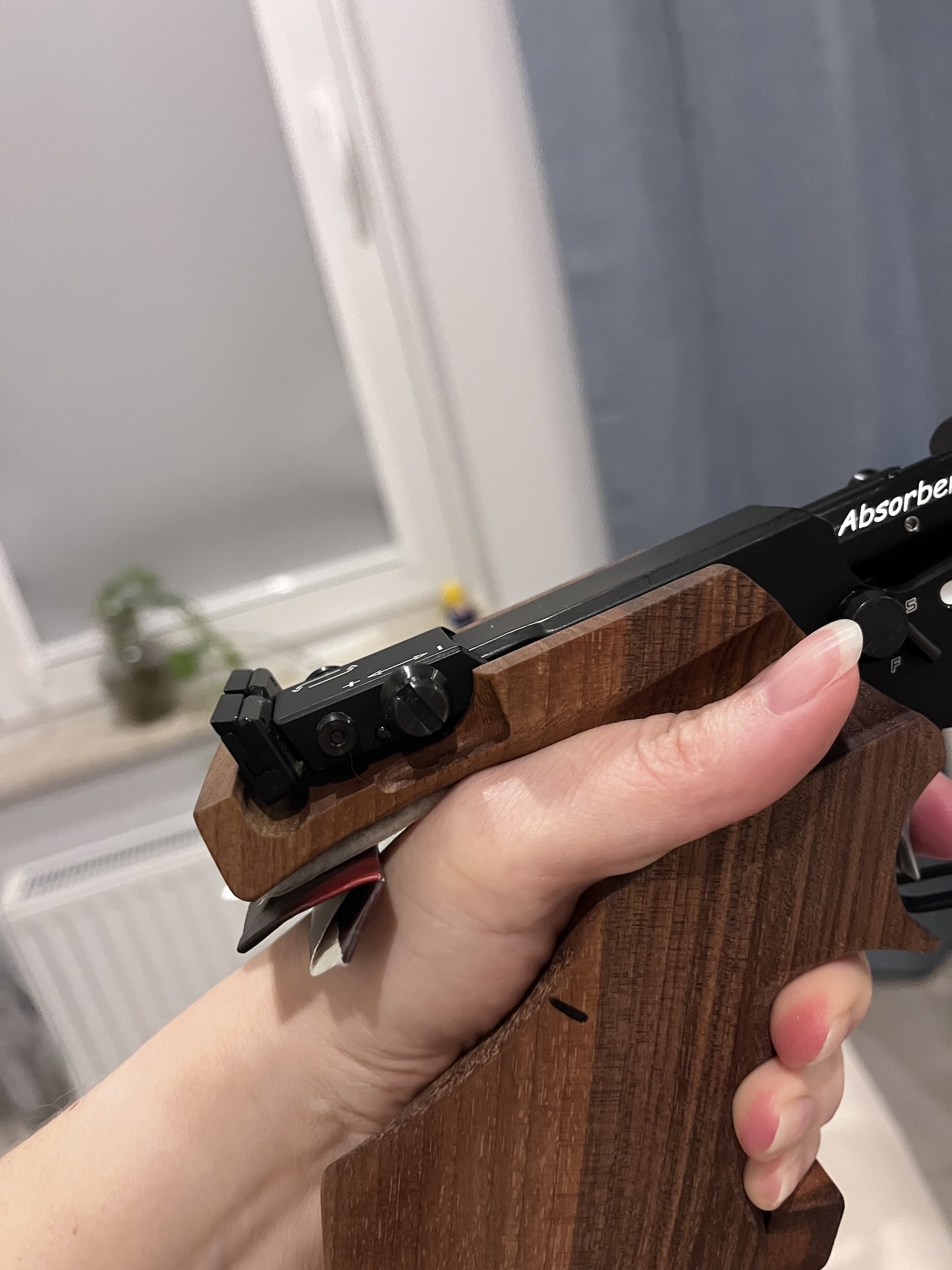

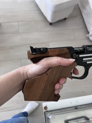

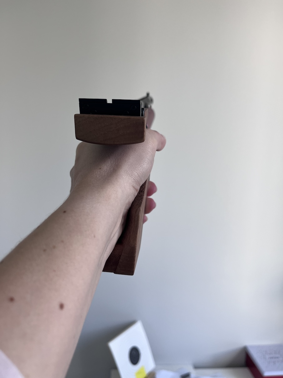

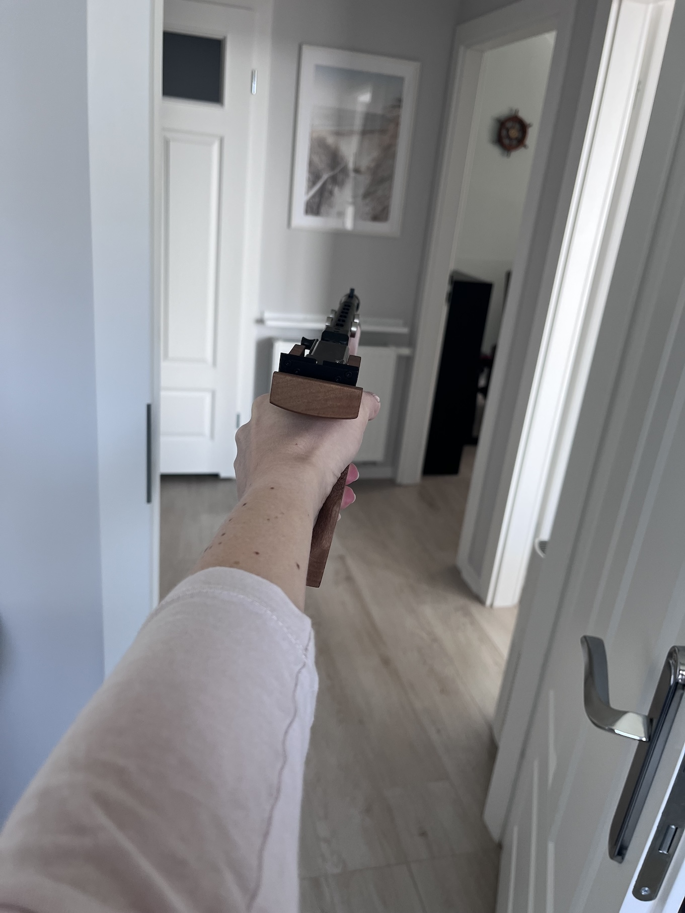

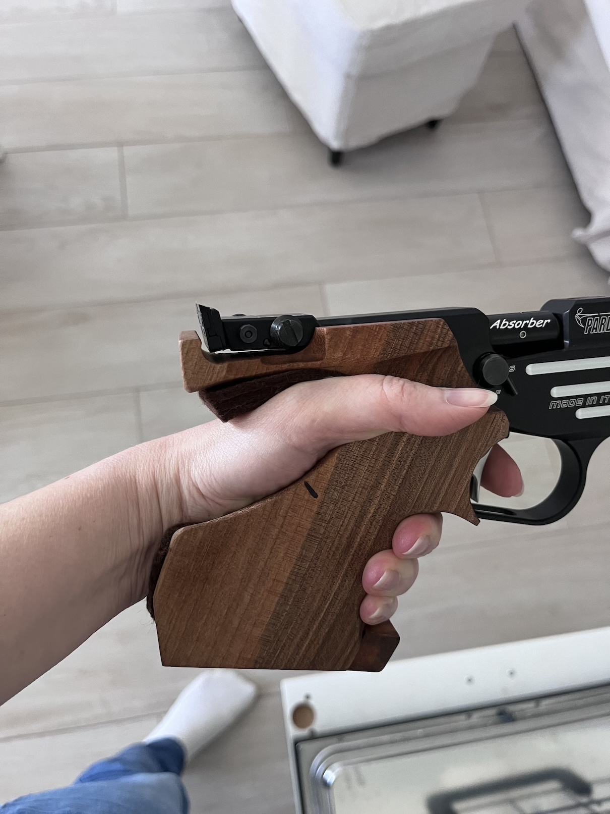

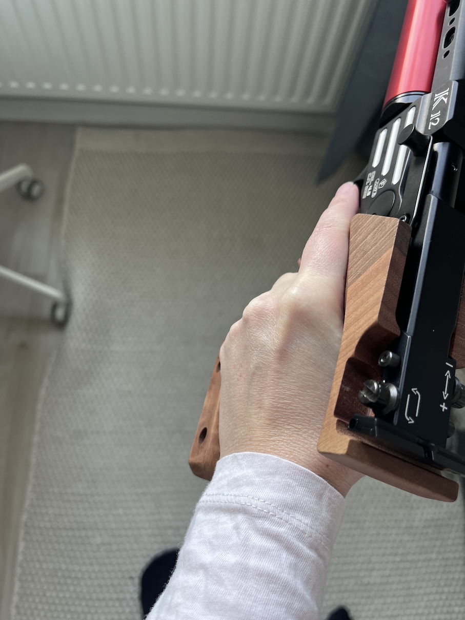

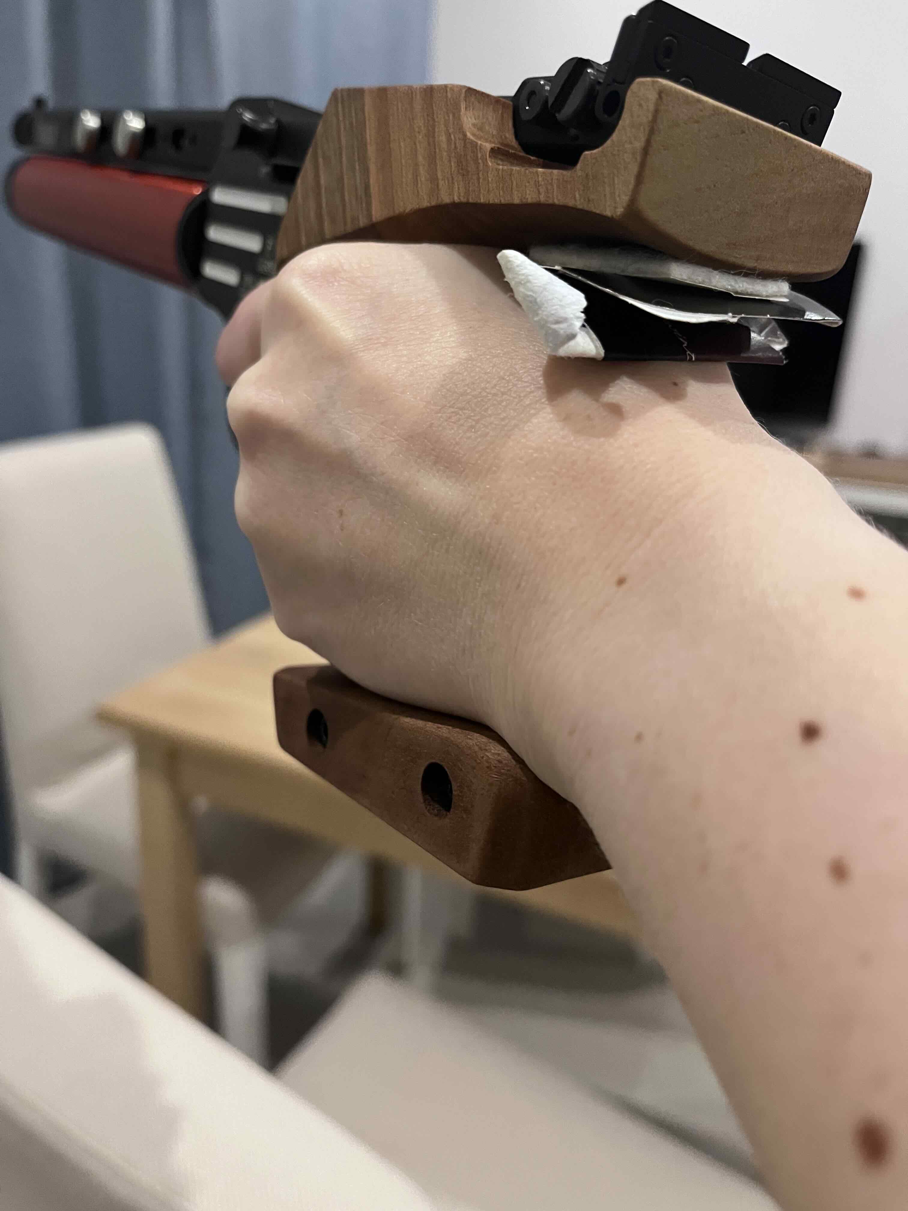

@Rover - we're doing a little each day with sander with my husband, I'm still thinking it's simply a little too large, even through I got the smalest left-handed Pardini available. But after a few weeks, a few bruises and a blister, I already feel more stable - so this may be it?
How to say if it's too large, or just needs some detailing? Attaching a few pictures of the current status (where I can finally wrap my fingers around!)

SOME people spend their lives tweaking their grips. In my opinion, most of them should spend more time fixing other issues in their shot process.
There are a few factors that are important about your pistol grip (i.e. handle, to differentiate it from the "grip" you use to hold it):
1) It should be comfortable, but it doesn't have "to fit like a glove". If you mold it exactly to your hand, and you age, the weather or your hydration level changes, it won't fit right anymore...
2) It should allow you to reach the trigger properly. With adjustable triggers, this is usually not an issue.
3) Once you have your stance lined up on the target ("natural point of aim"), when you raise the pistol with your eyes closed, the sights should line up on the target automatically. Pistols like Steyrs have adjustments to rotate the grip relative to the frame that can help fine tune that without putty & files.
4) It should have enough reference surfaces in the right places so that EVERY time you pick up the pistol, it is the same. Again, that does NOT mean it should fit exactly everywhere. I see shooters wasting all sorts of time getting the grip to fit their palm well. They'd be better off hollowing that area out...
For many shooters, what's most important is how they grip the pistol. You should use your non-shooting hand under the barrel to seat the pistol into your shooting hand so that it is ALWAYS in the same place and position. You want as much of the grip pressure as possible to be parallel to the barrel. Variations there won't move your shot significantly. Pressure on the SIDES of the grip will get you into trouble, because if that varies, it will steer your shots all over the place. Shooting a tight group is all about consistency. The most consistent pressure your can apply where you don't need it is ZERO. Keep your finger tips & thumb COMPLETELY relaxed, or better still, OFF the sides of the grip.

Based on the pictures, one issue I see immediately is that you have a gap between the base of the thumb and the vertical part of the grip on the right rear. That vertical piece is an important reference surface to ensure repeatability. If you aren't in contact with it, your grip will never be as consistent as it should be.
Basically, I think the grip is too large. I know it's an added expense, but you should probably get a Rink extra small, or possibly an extra extra small. I'd ask you coach if there is anyone in your club who has a smaller grip you can hold to see how it feels. Even if it's right handed, you can check the basic size. I'm not sure what model of Pardini you have, but I think this is the right page:
https://www.formgriffe.de/en/Pardini-K1 ... 58-K60/K12
In the meantime, you can put a thick piece (or pieces) of "moleskin" padding on the vertical surface to fill that gap. It's easily modified and removed.

There is definitely not enough contact above your hand, the "horn" of the grip is barely touching anything. You can add material there to help with that (an example would be Manu Bhaker's old grip). You are definitely expending a lot of energy holding the gun up as it is currently and that introduces quite a bit of shake.
I can't tell from the photos, but it looks like the palm shelf might be contacting your arm past the wrist bone. Judges are notoriously lax when it comes to that rule but it's worth keeping in mind.
I would personally advise on trying to sort out that top horn support before worrying about other anatomical aspects of the grip, trying to fill in other gaps in the palm are can shift your hold around and the Pardini does not have rotational adjustment.

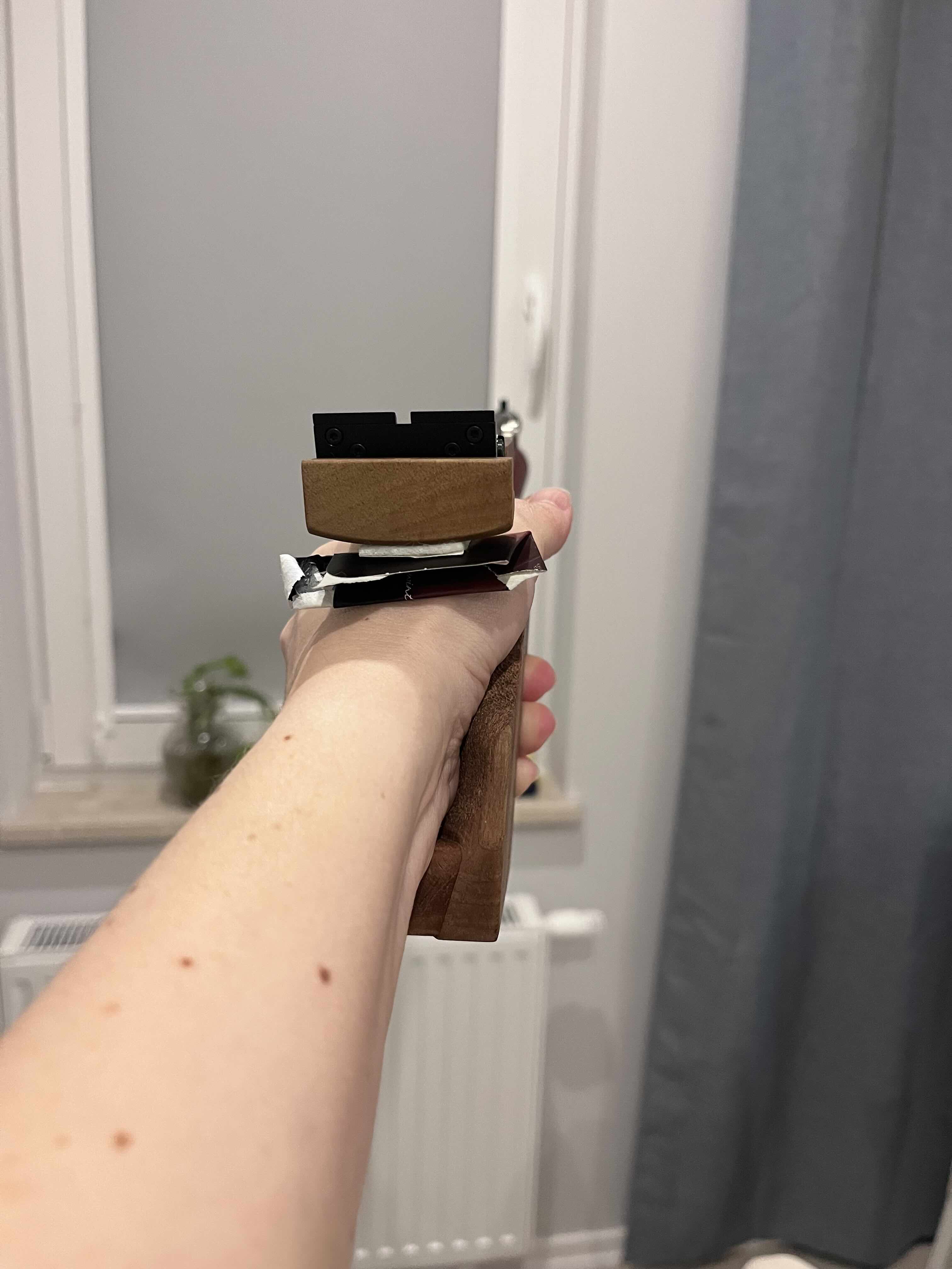

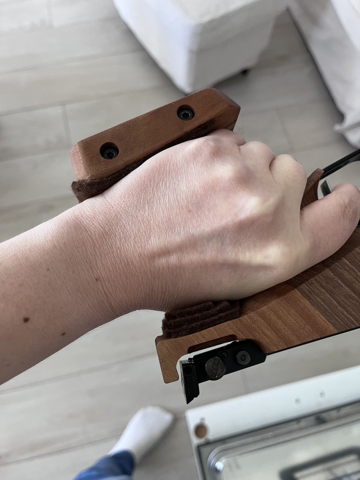

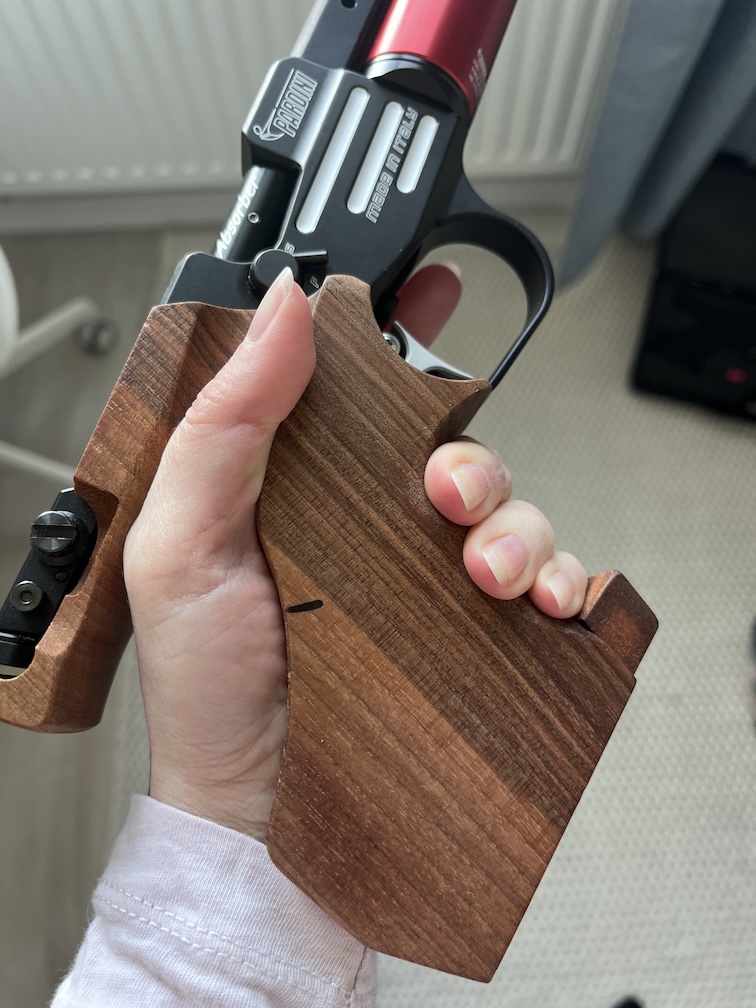

Is this carboard-felt model something you had in mind? With this I will definitely need to shorten the shelf as it's hurting my wrist beyond the bone.

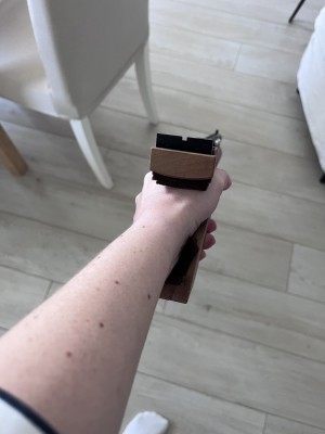

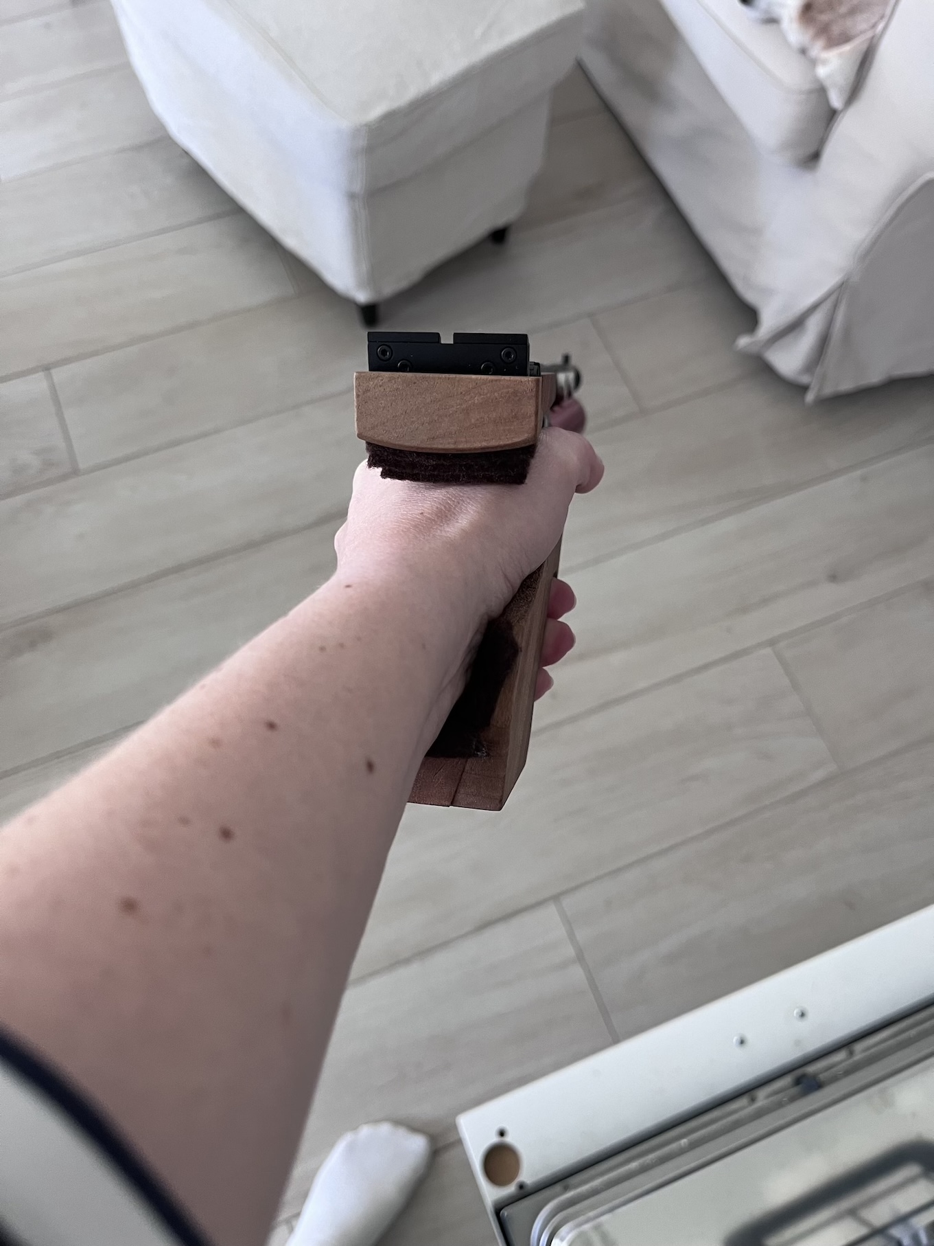

I'm assuming we're heading towards this kind of grip hold around the hand on the same K12 model?

You are doing fine and asking the right kind of questions.
Concentrate on "process" not "scores" the scores will come along as you perfect that process, you will do well not to get into "score anxiety".
As to the grip yes it looks large for your hands and the Rink grip is the way to go for us that have small hands, the lead time at the moment for a new grip is quite a few weeks, but is worth the wait.
As you are going to have to wait do some simple things to help you now - is the palm shelf up high enough if it is at maximum up and it is still not lifting your hand to under the "tail" cut out some 10mm cork tile to fit on the top of the palm shelf and readjust the palm shelf - you can reduce the distance the cork tile goes to your wrist joint to over come the discomfort. Attach the cork to the shelf with double sided tape or use a hot glue gun.
Another little tip do not curl your finger tips around the grip hold it with the middle joints on your fingers - there are lots of other "little tips" but try this simple stuff first.

agatek wrote: Sun Apr 13, 2025 2:48 pm Brillant, thank you.
Above the base of the thumb like that is not in a place where it will help much. You want it on the left side of the vertical piece of the grip below the base of the thumb where there is a gap. That should help you get a consistent grip with out the pistol rotating in your hand by varying amounts every time you pick it up.
The "moleskin" stuff the team I coach uses is found in drug stores (pharmacies, chemists, depending on where you are) in the "foot" section. It's used for cushioning loose fitting shoes to avoid blisters. There are two thicknesses. The thin stuff comes in packs of 3 sheets, and the thicker material comes 2 to a pack. It has an adhesive backing, you can cut it with scissors, and stack pieces. We have lots of small Asian women, and even the smaller Rink grips can sometimes need padding in places.
If the adjustable heel rest at the bottom of the grip is digging into your wrist, it's probably not legal for competition. I've had to saw the back end off of my wife's grip to shorten it enough, and then file the rear corner to round it over for comfort.

Thanks all for the comments - this has been a very good week. We managed to play a little with the grip, sandpaper and felt and indeed it fits better. A little more carving to do, but the difference in feel is stunning. Any other comments to home modifications are welcome (before I oder an XXS one!)
Little by little we will make it work, and the score will get up.
