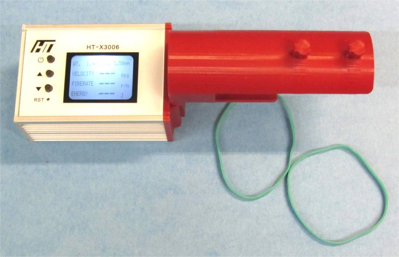

I just realized I never got around to posting photos of the 3D printed mounts I'm working on. I've replaced the end mounting plate with one with a dovetail to accept different adapters. Here's a picture of the chronograph with the end plate and a Benelli Kite adapter:

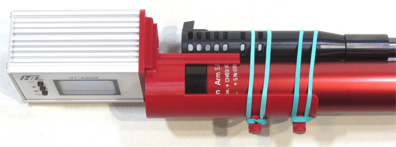

Here it is installed on a pistol:
HT-X3006 Kite Mount (sm).jpg (46.54 KiB) Viewed 56745 times

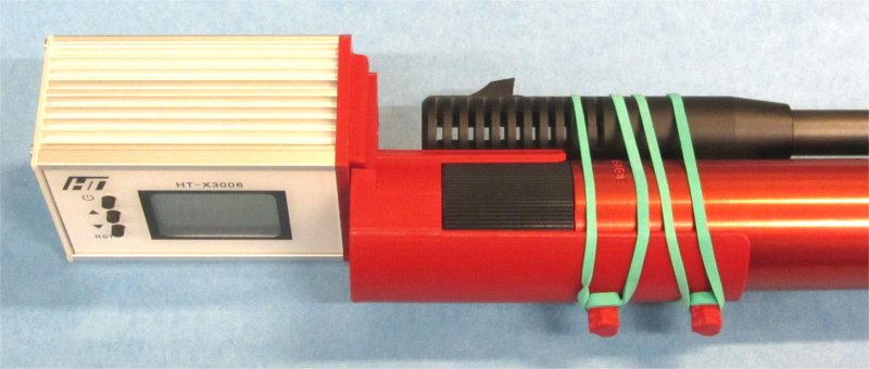

And here is the chronograph with an adapter for Morini 162EI pistols:
HT-X3006 Morini Mount (sm).jpg (36.66 KiB) Viewed 56745 times
I have adapter designs printed for Steyr LP10's, and Hammerli 480K's. I've got one in the works for Anschutz LP@'s, and I will also be developing one for Hammerli AP20's as well. Once I have them all finalized, I'll park the files on Thingiverse.
