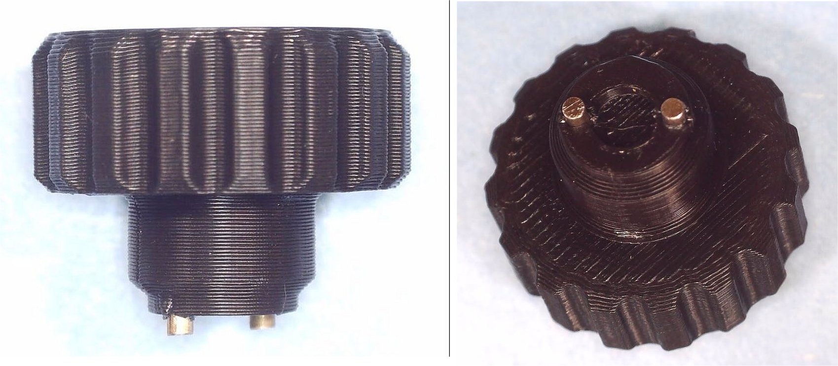

It's taken 6 years of research since he died, but I now have the parts, tools and expertise to fix the 12 dead pistols we have now. One issue is that you need a special small pin spanner to take the regulators apart. I spent considerable time machining a fancy one out of steel, only to discover that the force required to unscrew the adjustment bushing is pretty low. I designed a 3D printed tool with a U-pin of spring steel, and made up a batch:

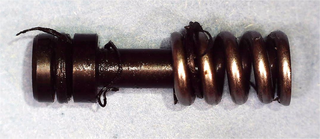

The problem is a special piston seal they use in the regulator. Instead of an O-ring, they use a "X-Ring", sometimes known as a Quad-Ring. These tend to shred:
Many of the repair parts for the pistol are used in other Hammerli/Walther air guns, and are still available, but not the piston seals. I suspect they ran out of spares a while go due to the high failure rate. I managed to buy a couple complete AP40 regulators, which included the required seals. I measured them, assuming they were going to be some exotic metric X-ring. I discovered they are bog standard "-007" sized ASTM/SAE X-Rings, available from McMaster Carr at $11.21/100.
I've just finished re-sealing seven pistols over the last couple weeks, with 5 more to go...
My one concern is that we had some fail within 2 years of being converted. I don't know if the X-ring is overstressed, or if the seals Larry had were old & tired. The ones I bought are Durometer (hardness) of 70, and I suspect a Durometer 90 seal would hold up better. I haven't found any on-line, but I haven't had time to ask around. The good news is that it only takes about a half an hour to take the regulator apart, clean & lubricate everything, replace the seal and reassemble it. If you take notes of where the adjusted was when you start, the velocity will come up within around +/- 25 fps of the nominal 475 fps.

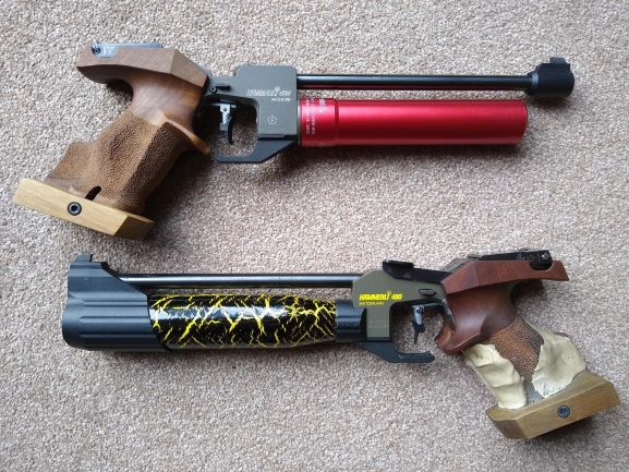

My 480K2 works just dandy at present but I've always had a little niggle that, some day, it'll become a paperweight like my 480 which hoses out air only marginally slower than I can get it in. Knowing that there's now hope after seal failure has raised a smile.
A Happy New Year to you and Kudos for taking the time and effort to save your School's guns and sharing the info with other shooters.
Posts: 3581
Re: Anyone Need Repair Info on Hammerli AP40 or Converted 480K Air Pistols?
It may make interesting reading/viewing, but the regulators in those two pistols are different from the AP40 cylinder system. The regulator in the older pistols was partly contained in the "male" fitting that goes into the rear of the cylinder. The AP40 regulator system that I've been repairing (did another one just last night) uses a "male" fitting on the end of the cylinder that goes into the pistol frame.
You would need to track down conversion parts, and installing them requires some metalwork. I've been searching for extra conversion hardware for 6 years, and haven't located any. Walther used to do the conversion at the factory, but that is probably no longer an option.
I've just about finished editing a series of videos on how to repair the AP40 style regulator. I'll post when I get them up on YouTube. You'll see that it very different from what would be required for the un-converted 480's. One annoyance is that Hammerli kept the inner workings of the early pistols a deep dark secret. There are NO exploded diagrams that show the regulator parts or the firing valve system until after the 480 K2. That also means there are no part numbers to go looking for replacement components.

We have several pistols that are in use by students, and appear to be working fine. I checked a couple with a chronograph. Both of them exhibited low (~ 400 fps) and erratic (+/- 10 fps) velocities. I brought them home, and took one apart last night. Sure enough, the X-ring was shredded. It's been re-sealed, and I'll do the second one today.

thanks for this insightful thread. A colleague of mine also currently has a leaking 480 in the area of the screw that can be opened with your 3D tool.
Would you also have a technical drawing with dimensions for your tool? A friend of mine could also create this tool for me on a CNC machine.
Thank you very much
Posts: 3581
Just to be clear, the tool & approach I described required to fix the 480K's ONLY works if they have gone through the conversion to use the AP40 style cylinders. The internal workings of the original 480K regulator are not documented anyplace I've found, and the design is VERY different and a lot more complex.
I have attached a zip file with a STEP file and an STL file for the tool I designed. All that is needed to complete it is a U-shaped piece of 25 gauge music wire, which is 0.059” in diameter, or 1.4986 mm.
