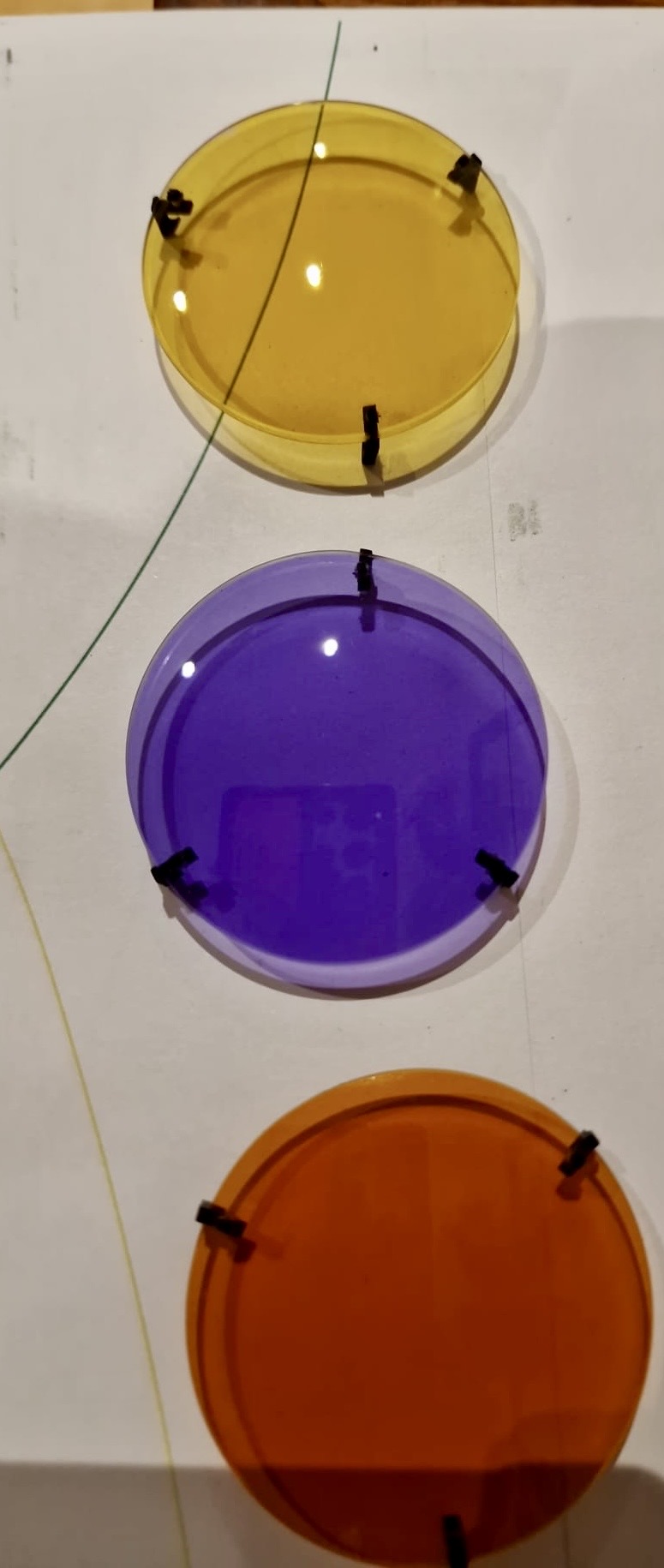

I was also at Wales and had similar struggles on the megalink targets. My spread was a lot wider and it was hard to hit the middle. Talking with my sport optician now. Another shooter showed me some of the lens filters they had, yellow, magenta and others - did not get to test properly but I’m looking for a place to try (before another big event).
I have a lens from a sport optician with a shallow depth of field that focuses on the front sight without my eye doing any work - they make a great difference in general and you can get clip-on filters for different environments

For brightness use a Grey filter all of the others are used to make the "white" and the black contrast better and normally used outdoors in daylight, everyone sees differently, but those megalink targets use LED's to light them up so will be at a frequency of about 6000K which is the frequency of daylight. Unless you can borrow some to try on them it is going to be an expensive experiment but I do know people use grey filters when using them. You can get different densities of grey too so it is opening up a whole new can of worms going down the filter route.
