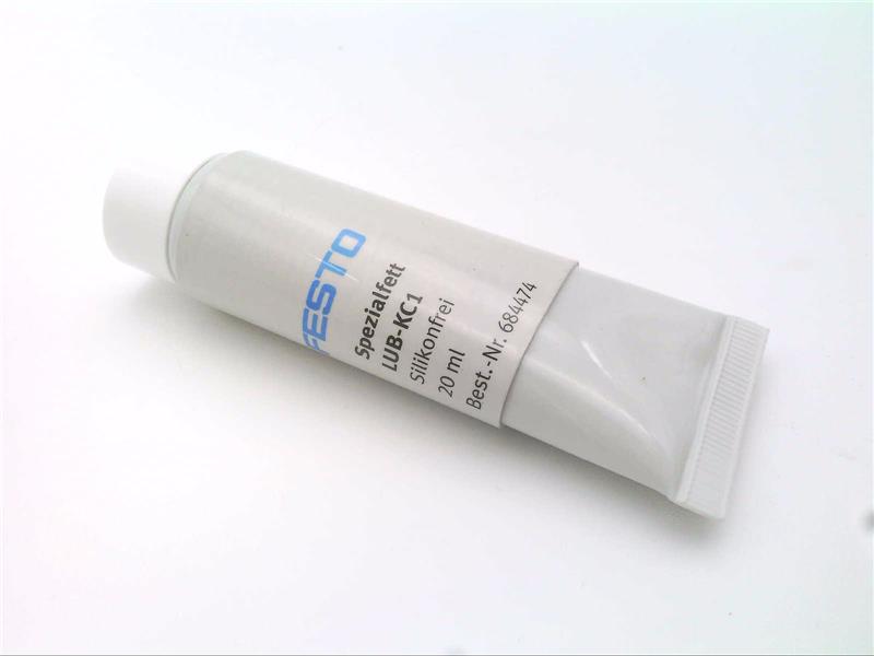

Re: FWB P44 probe 0-ring
My favorite is Festo Pneumatic assembly grease.
