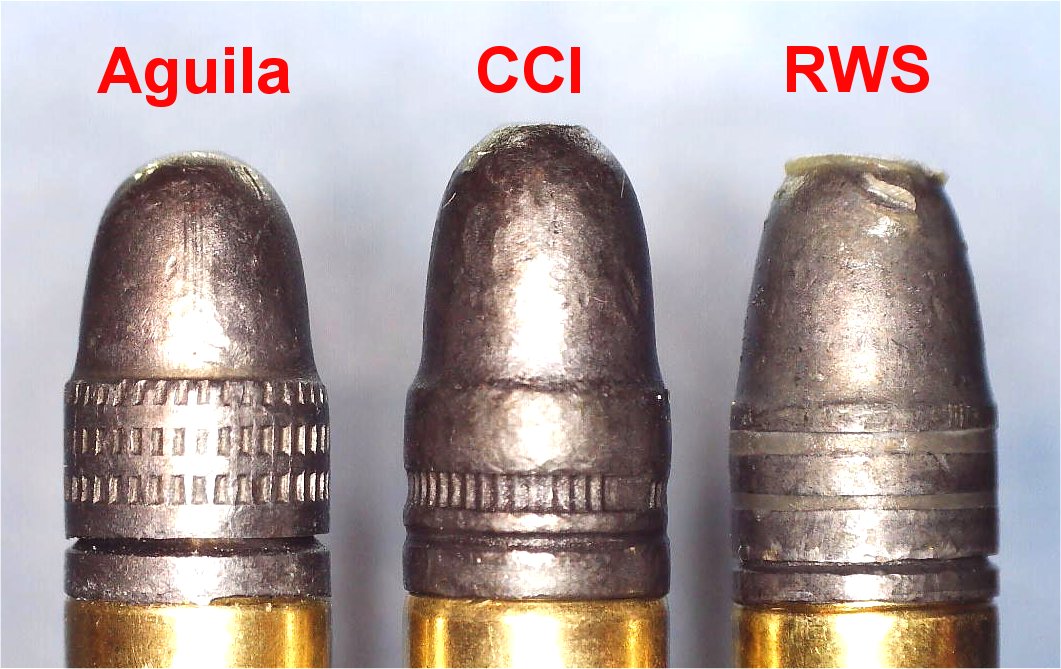

Different ammo has different bullet shapes. Pistols that have feeding problems may work better with rounds that don't have a large/sharp shoulder on the bullet. Here's a comparison of Aguila, CCI, and RWS:
RWS tends to feed better in fussy pistols than the other two. Norma TAC-22 is loaded by RWS (the cases have an RWS headstamp), and is an economical alternative to a lot of the more expensive European ammo.
