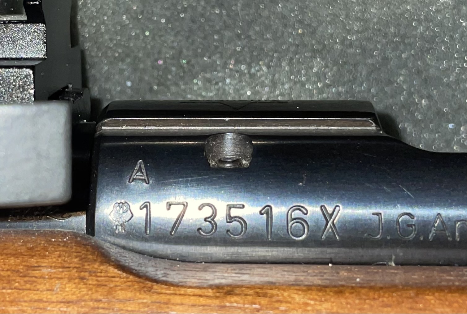

I do have a quick question… what does the A over the serial number stand for?
Posts: 2104
Re: Question about 1600 Anschutz
Opusxc100 wrote: Sun Apr 28, 2024 9:20 pm I do have a quick question… what does the A over the serial number stand for?
No-one seems to know. It's not a proof mark, or part of the regularserial number. A suggestion is it indicates rifles to be sold in North America,. It might also show a duplicated s/n.
justadude
Posts: 803
Post by justadude »
Tim S wrote: Mon Apr 29, 2024 1:12 am
No-one seems to know. It's not a proof mark, or part of the regular serial number. A suggestion is it indicates rifles to be sold in North America,. It might also show a duplicated s/n.
There is something to the theory about the 'A' indicating the North American market. I picked up a 1972 serial number 14xx series barreled action #103xxx, (Light barrel so it was probably in a 1407) that was brought in from Europe. Beyond knowing it came in from Europe, the barrel was not even tapped for the scope blocks that would have been typical for a rifle sold directly to the US market at that time and, there is no 'A' stamped into the receiver near the serial number.
Not definitive proof that the 'A' designates a North American or US market but does add to the theory.
'dude
Posts: 2104
'Dude,
I certainly can't recall seeing an A on a rifle over here. Although I'm still not sure why Anschutz would need to mark rifles destined for North America. Heavy barrels of 1970s vintage here have 'scope blocks too, as do the odd ISU weight, but there are no distinguishing marks. Was it something required by the deal with Savage to import and market each others rifles?
Opusxc100
Posts: 23
Joined: Sat Apr 27, 2024 9:55 am
Post by Opusxc100 »

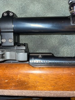

I’m going to try and figure out how to post a picture. I tried at the beginning of this thread but the file was too big. Hang in there while I figure this out. Thank you
Opusxc100
Posts: 23
Post by Opusxc100 »
Ok, let’s see if this works
Serial number
Serial number
Posts: 2104
Is that a Redfield 3200 or 6400?
Post by Opusxc100 »
This might be better
Serial number
Serial number
