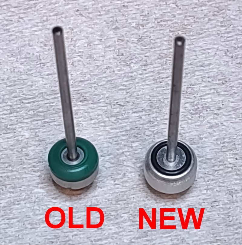

I replaced the regulator with our spare. In the process, I discovered that the firing valve seal was different from the spare we have:
I wasn't absolutely sure if they had changed anything else internal to work with it, so I left the old one in place. Is the new version a direct replacement for the one with the green O-ring?

Gwhite wrote: Sun Feb 25, 2024 8:34 pm I wasn't absolutely sure if they had changed anything else internal to work with it, so I left the old one in place. Is the new version a direct replacement for the one with the green O-ring?
No, it's the same part with a different seal.
I've replaced a couple of the old type with the new ones, and had no issues.
