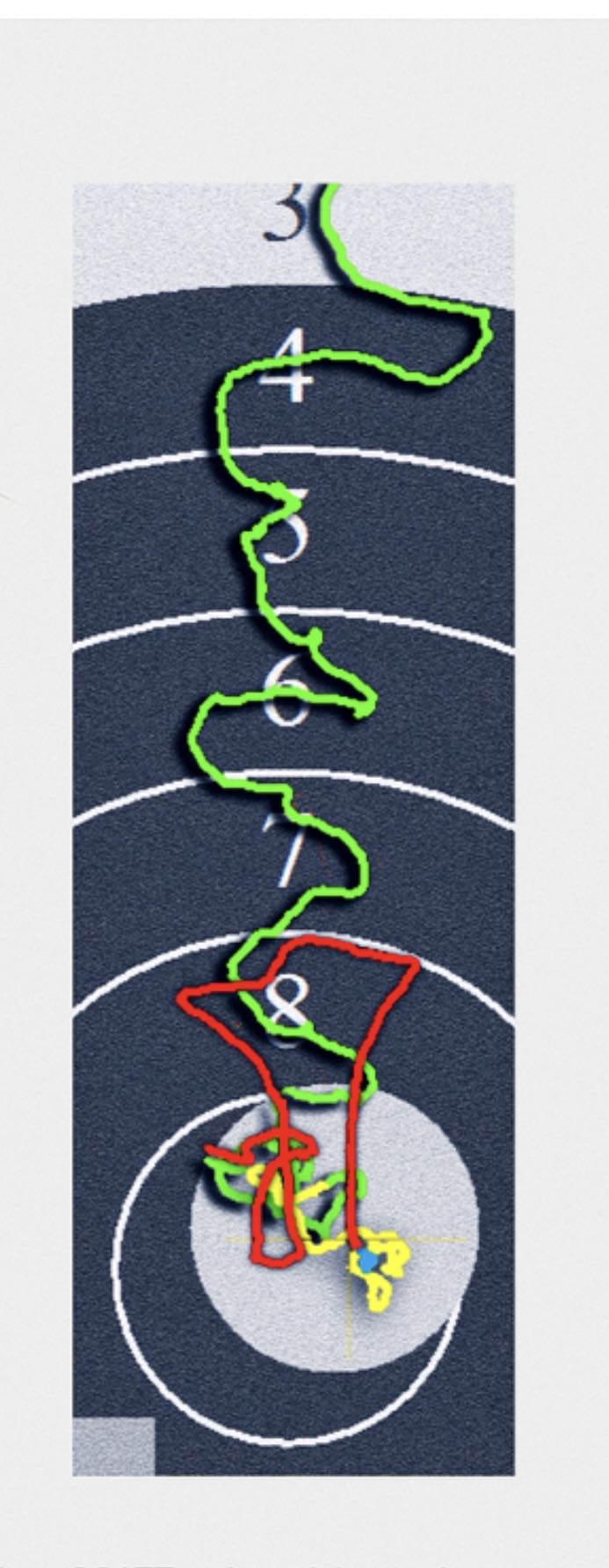

How to obtain such a curve in air rifle 10m??
Post by loadcc »
How to obtain such a shooting curve? aim at a point above the center, hold breath, stabilize, exhale, aim down, aim at the center, stabilize, and shoot. Is that so?
hope to get any suggestion from u.

Training + clothes.

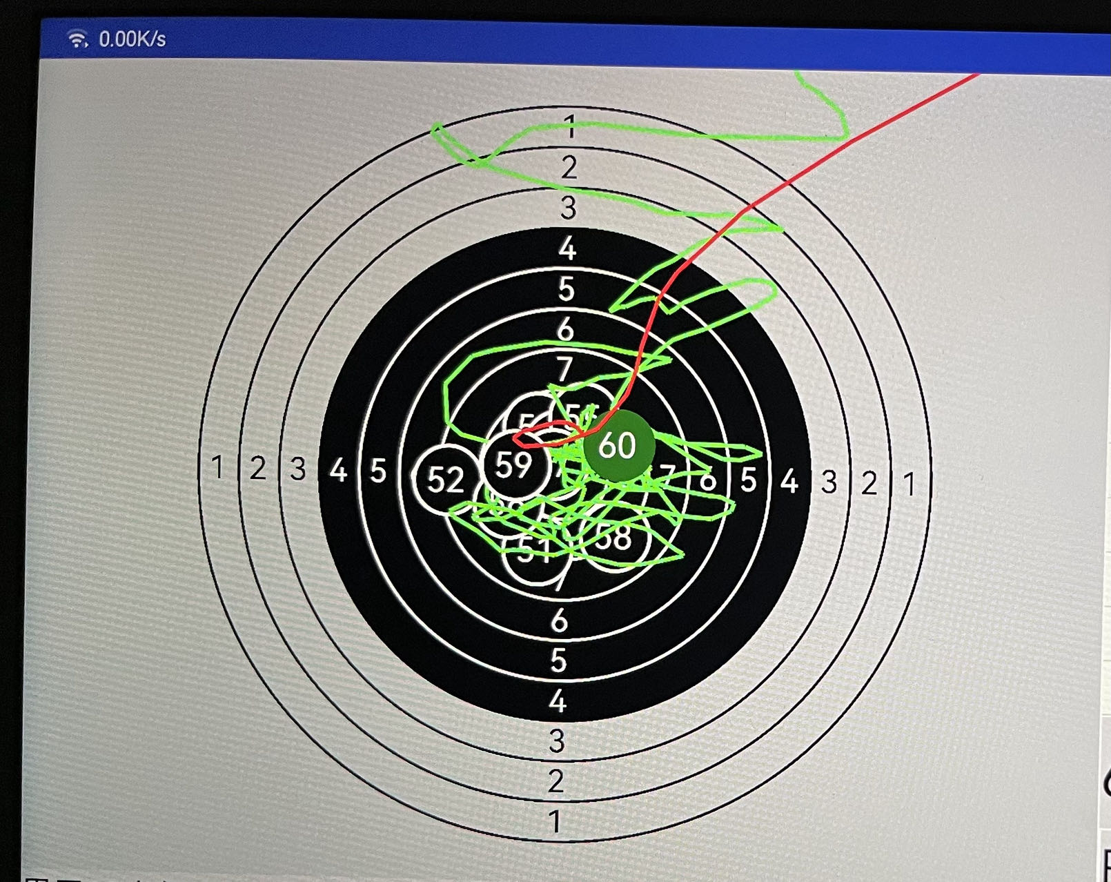

Post by loadcc »

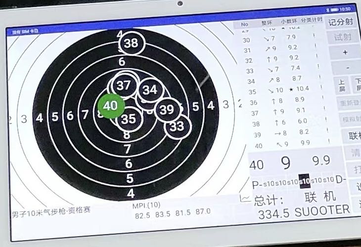

my curve,what's the problem and how to train.??
10.9
KabalMSU
Posts: 14
Joined: Sat Feb 25, 2023 11:14 am
Location: Germany
Re: How to obtain such a curve in air rifle 10m??
Post by KabalMSU »

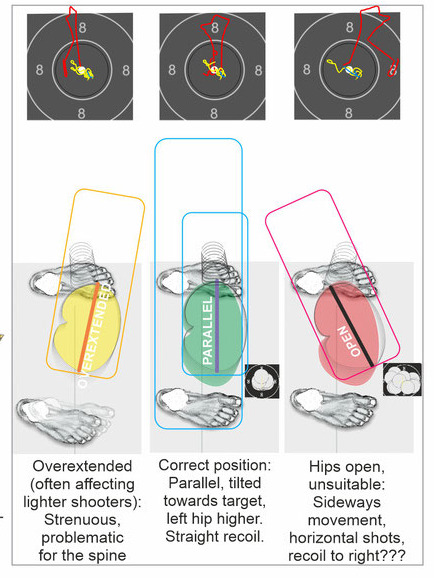

You force the muzzle into the middle - your trace comes from top right and recoil goes there then. The trace in your first post is defined by gravity only.
Post photos of your stance here.

How do shooters who make traces like the one in Post #1 typically lower their aim onto the 10 ring? Is it done by breathing out until the sights are centered on the bull or does one let the elbow of the arm supporting the rifle forend settle deeper onto the hip until sights are aligned? I've looked online and in several books and couldn't find an answer on how to make the final approach to the bull.
I found an interesting article by a well-known high power rifle shooter, David Tubb, who approaches the bull from the left since the vertical position is more fixed than the lateral one. I realize that this is quite different from what smallbore/AR shooters do.

I can't say I ever made it to that level when I use to shoot competitive smallbore and air rifle. However, I can tell you something that worked for me, and what works for the shooters I have coached over the years.
If you look at many top level athletes in standing, they spend a good amount of time setting up the rifle as close to the bull as possible before they put their face down on the cheekpiece all the way. It is a good idea to study video footage from world cups to get an idea of this. Here is a much older video from 2004; I used this to illustrate this exact point to our shooters at smallbore camp. You don't have to fidget as much as they do, but it will give you a good idea.

Make sure your hips are perpendicular to the firing line and the rifle is over the center of your feet as much as possible. It would be helpful to make sure your body is truly aligned with the bull; if you can mark the very center of the target on your firing point see how it aligns to your feet. In a perfect world it should go along the center of your feet; for me it was a little closer to my toes.

thanks for u tip's, i take a stance photo and find a hips twist.i will fix my position and see what's change in the curve.

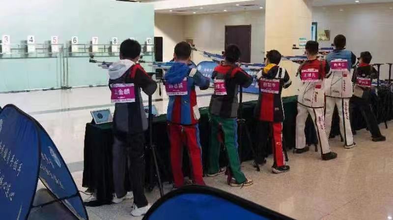

Since able to stand still, I will definitely find a way for me to hold an air gun without moving, but it will be different for each person.gun should suit for shooter,NOT shooter suit gun.

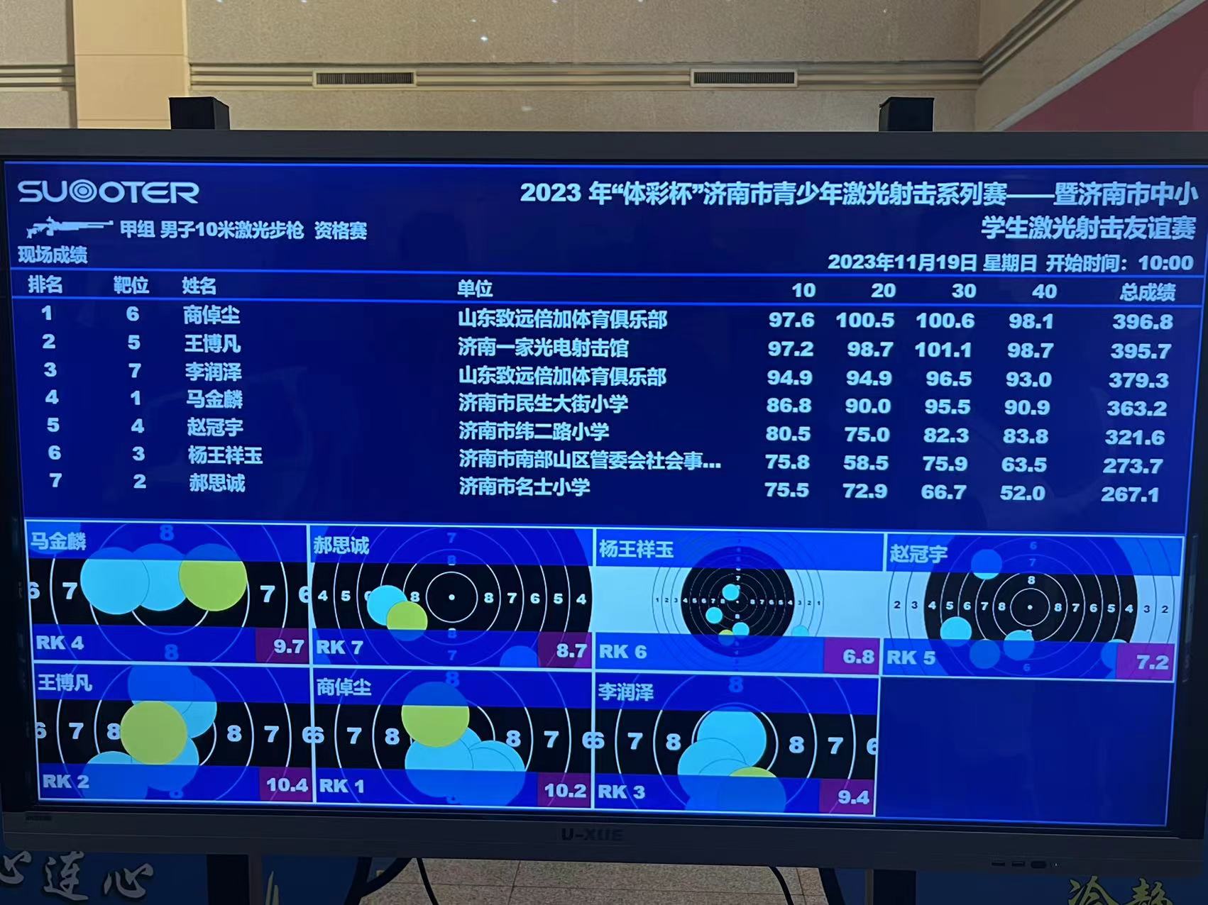

Based on this idea, I won a friendly competition between primary and secondary school students yesterday in my city with 396.8 score in 40 shoots.i use 8 breath in the competition,3 in off-hand\2 in hold gun\1 set the face and aim in bull\1 for hold and shoot. take about 30 minutes for 40 shoots. it/s seem work for me.I spent the first 5 minutes of the game searching for my NPA,AND USE “sway”。competition with laser device。
i browse MEC site yet , but it is also too expensive for selling book, especiall the high deliver fee.
by the way, youtube\facebook....... not available in my area.so this site is very good for me.
