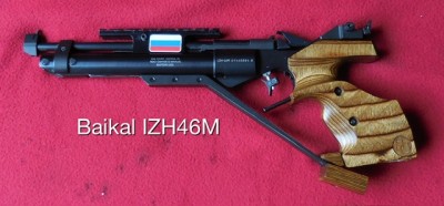

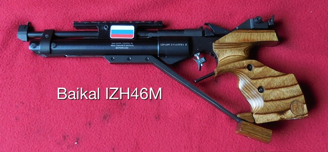

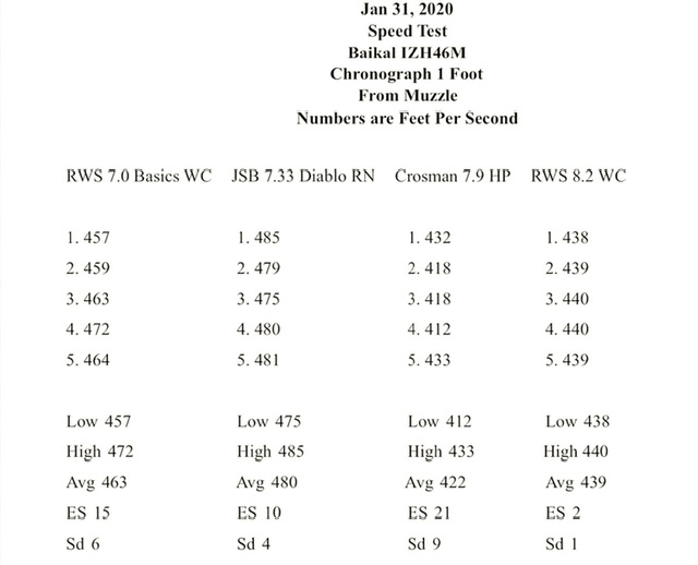

My old IZH46M (about 22,000 shots so far).
Of course the Crosman pellets are VERY tight:
