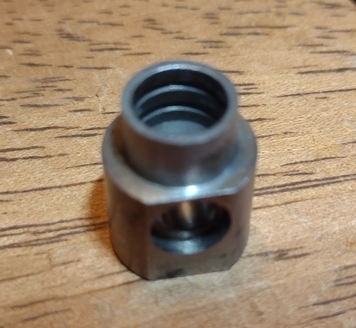

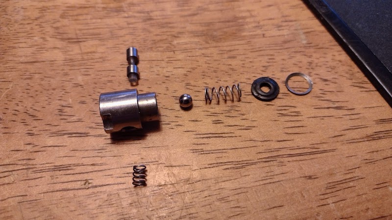

Valve on LP3 confuses me. I searched for info on how to assemble the LP3 and found some forum posting that had all parts laid on table. Also note that there were at least two versions of valve.
Attached is photo of my LP3 valve body and parts I have for the valve assembly. Is there something missing?

My main issue with the valve was that I saw pictures of disassembled pistol and there was a part called "Spring guide"
I was unsure if my pistol was missing that part or if this version of valve didn´t come with it from factory.
Found dimensions of the guide so I turned one from brass yesterday. Valve still doesn´t hold pressure, but it is better. Trying to source proper seals.
Also missing the pin between striker and valve and small locking screw from barrel pivot screw.

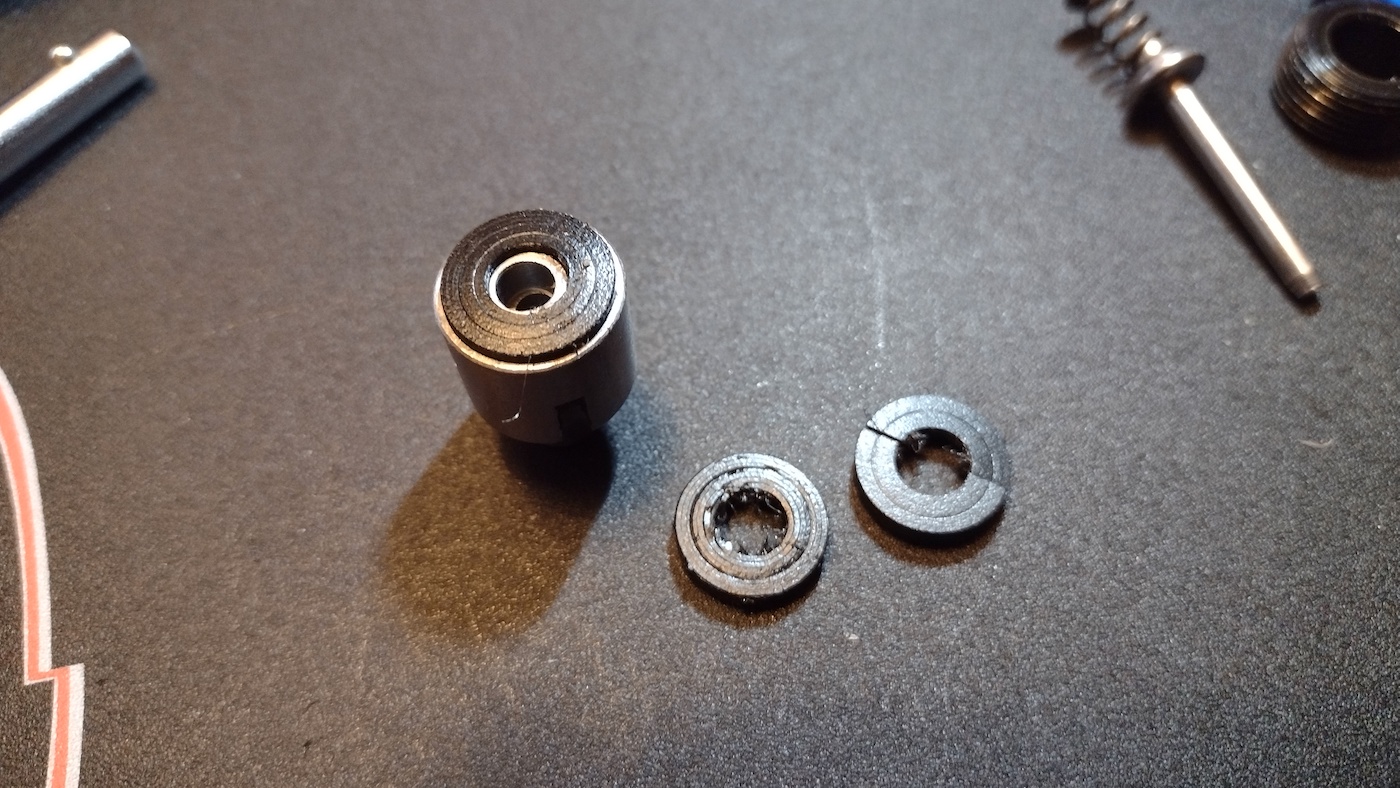

I tested that 3D printed TPU material on Walther LGR SSP Air rifle valve seal.
First version worked for 3 discharges :)
Second didn´t work at all, think it was too thick and deformed when installed. I cut that in half to see how well shape fits valve body.
Third is ok, we´ll see how long it lasts.
I have a small lathe, trying to source suitable material to make seals.
Also have a resin 3D printer that I haven´t even tried yet. Resin materials -as far as I know- aren´t flexible but parts are more precise.
Could be used to make mould to pour PUR in...
