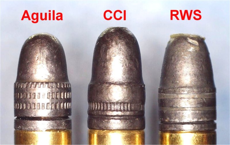

I went to the range to practice today, and tried SK Pistol Match ammo. The heat & humidity finally got to to be too much for me, and I stopped after 50 rounds. I didn't have ANY issues with difficult feeding, but the ejector would only pop the cases back 3 or 4 millimeters, and I'd have to remove them manually. I got pretty good at flicking them out with a fingernail. I found this far less annoying that having to to jam rounds into the chamber, and it was almost automatic by the time I melted & crawled home.
In addition to the lube, I've seen evidence in my MG2 that makes me suspect the SK cases may be softer brass. If so, they may expand more on firing. In examining the fired cases, I see less carbon on the outside near the mouths than with the ammo that gets hard to load. The reduced carbon getting blown back around the cases may help with feeding, but the increased expansion of softer brass might make the rounds harder to pop out. The poor ejection may also be from higher pressure. I'm guessing the "pistol" ammo uses faster burning powder than typical standard velocity designed for longer rifle barrels.
I'll have to experiment some more, but it may also have to do with the different bullet shapes between brands. I don't have a photo (yet) of the different free pistol options, but here is a picture of a couple brands the college team I help coach uses:
The full diameter portion of the RWS bullet starts further back than on the other two, so it may not engage the rifling and shave bits of lead off to hinder feeding.
