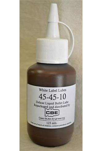

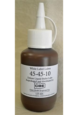

Hi porkchop, I've found it: 45-45-10, is 45% Lee Liquid Alox, 45% Johnsons Paste Wax concentrate, 10% mineral spirits.
Not sure what the Australian equivalent is to Johnsons Paste Wax but a local outfit sells the concoction ready-made (for Australian consumption only):
