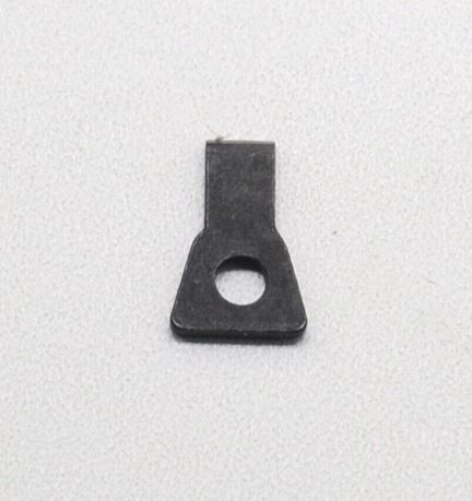

Hi everyone - OK, so I've got the vertical adjustment on my Baikal IZH 46M set as far down as it will go and I'm in the 7/8 ring. I aim 'sub 6' style already, so it's not like I can just aim lower.
Has anyone adjusted the front sight up? Is there a longer blade available (I can't find one on Google, but...). Or can the rear sight be moved down somehow?

You need a taller front sight.
A quick google search got this image for the front sight
It looks like something that you can cut out of back plastic (bottle, packaging, Eley .22lr box, etc.), if you are not able to work with metal.
Drill it first, then cut the shape around the hole. Leave the sight long, and cut it as needed so the rear sight is near the middle of it's adjustment.
I've done countless rear and front sights from all sort of material, from plastic, aluminium, metal. They all work great, and are far easier to make than they look.
Hope this helps

rmca wrote: Sat Mar 04, 2023 9:32 am You need a taller front sight.
I had dismissed the idea of making one because while I have most of the tools, I don't have a bench and a vice for working with steel.
But I had not thought about plastic or aluminium! I'll have a poke around for something suitable.
Thanks for the inspiration!

I used a bit of plastic that used to be a battery cover for one the kids' old toys. It's about the right thickness and a slightly smaller hole that the metal original allowed the grommet screw to hold it securely. Now the elevation is set in the middle and I'm hitting the middle of the target - success. Thanks again, rmca.

I had a friend 3-D printed the square block with front sight on top. He 3-D printed multiple blocks with different sight heights for me.
I really recommend you do that, for two reasons.
One, it solves your front sight height problem.
Two, more important for me, it lessen that IZH 46 front heaviness.

seamaster wrote: Sun Mar 05, 2023 8:27 pm I had a friend 3-D printed the square block with front sight on top. He 3-D printed multiple blocks with different sight heights for me.
Brilliant idea. What I have is working, but I like your idea for a permanent solution.
You don't by any chance happen to have the .stl or .obj file, do you?

My IZH46M came with two rear sights (you turn it over) and three front sights.
Careful the rear sight screws turn backwards.

I just snipped the end off a tie wrap/zip tie and superglued it to the front sight. Amazingly, it was right on at 100 and I still had rear sight adjustment.

No necro bumping intended. But, for other people reading this. Might be good to add some nuance.
I also received extra front and rear sights. But the do not vary in height. Only in width.
So this can not help you, unless you want to cut a piece off, or enlarge, or use for measure etc.
I had the same problem as the topic starter, who most likely has already found a great solution.
Went back with the pistol to the store.
In the store the salesperson left with my pistol, so could be that I did not see everything.
But what I saw was that he just pushed the rear site down with his finger.
This took away resistance so that the sight had more space to turn into the "down" direction.
