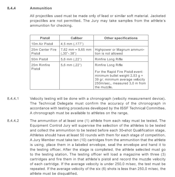

Does anyone know what ISSF rule 8.4.4 really means?
25m Center Fire
Pistol
7.62 mm – 9.65 mm
(.30”-.38”)
Highpower or Magnum ammunition
is not allowed
From my perspective:
9mm is a high power cartridge
It operates at magnum pressures or pretty close so really its a magnum cartridge.
Has anyone seen anything definitive on this?

8.4.4 Ammunition
All projectiles used must be made only of lead or similar soft material. Jacketed
projectiles are not permitted.
so 9x19 FMJ/HP/SP are not eligible for CFP.

This is what is written regarding ammunition:
JamesH wrote: Mon Mar 06, 2023 5:49 am I'd dearly love to be able to exclude the morons who shoot 9mm and and think 150/600 is a terrific centrefire score.
If you want to use the ISSF rule book to do that, I would go with the jacketed bullets.
Hope this helps
