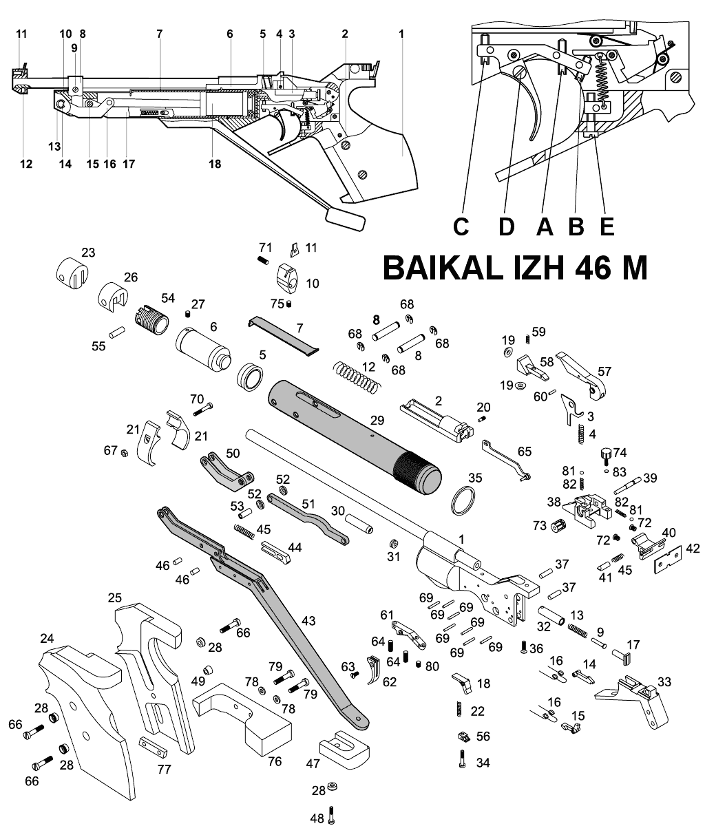

Does anybody know, what part/parts are responsible for keeping the breech block up after cocking?
Mine just does not want to stay up, requires raising after cocking. Started from not staying sometimes, gradually went to always dropping.
TYIA
Posts: 647
Re: Izh 46(M) breech block

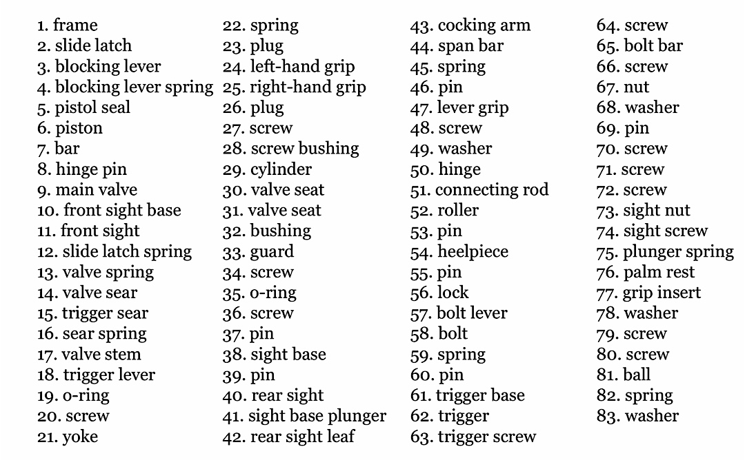

Look at spring #4 in the attached diagram (directly below the words IZH 46M). It may have just come unhooked. (That has happened to us, in the past.) There are also some instructions for disassembly on Pilk's website.

Thanks. #4 is in place, not worn off and well hooked, problem is probably with something else :(
Posts: 3584
It's been a while since I was inside one, but I think it stays up by virtue of the shape of the lower surfaces of the block where meets up with the valve stem (#17). It has a camming action, and if the surfaces of the lower corner of the block get worn, it may not want to stay up.
UnGe
Posts: 166
Post by UnGe »
Yep, #17 was my suspect, as it has signs of wear.
As the breech is able to stay up when the gun is pumped, I tried to extend valve spring, but it did not change anything.
I do not have problems with manually raising breech after cocking, but once in a while on the way up (pressing on the valve?) it causes some air loss, which is obviously not fine.

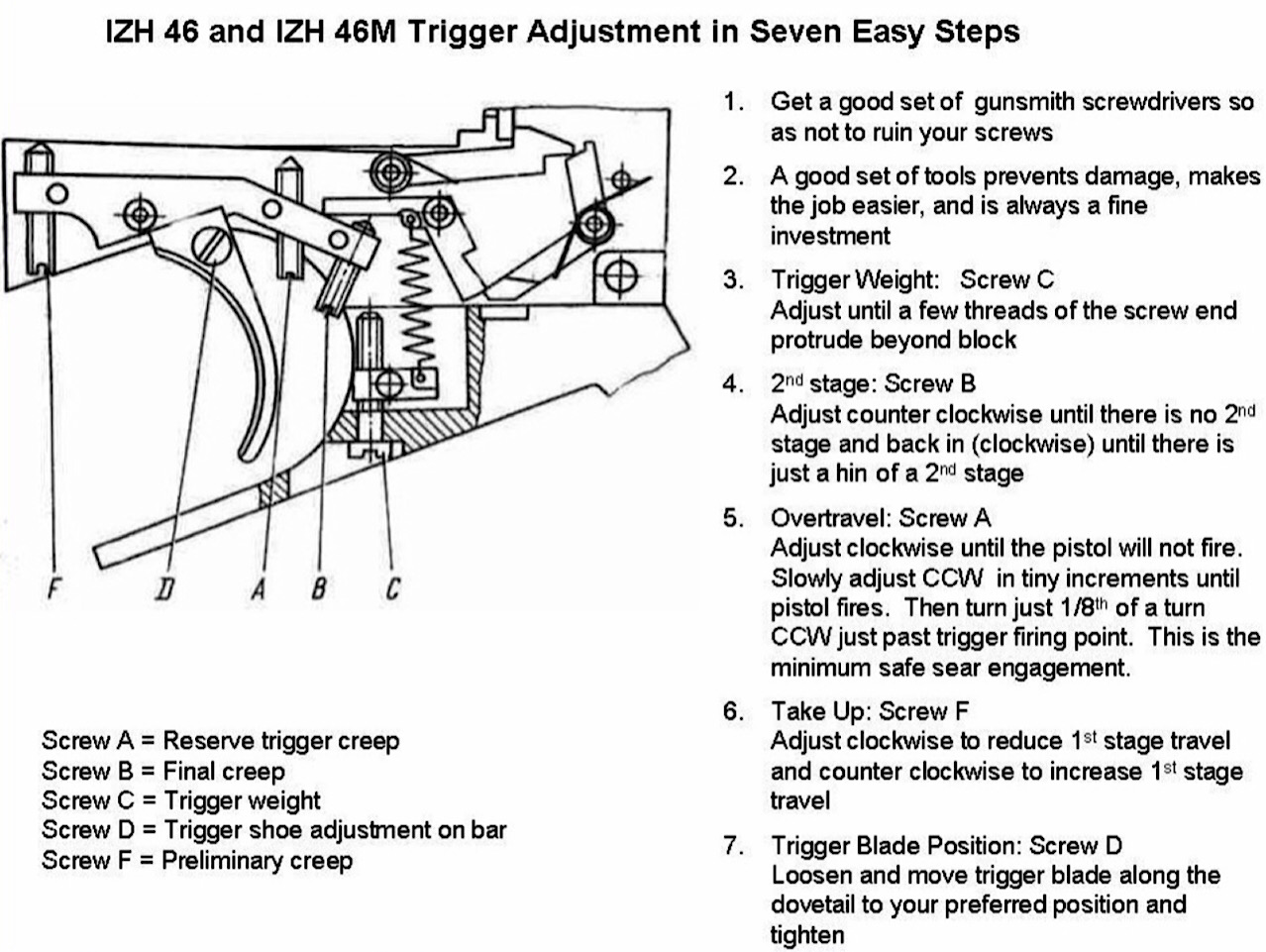

Trigger adjustment instructions...
