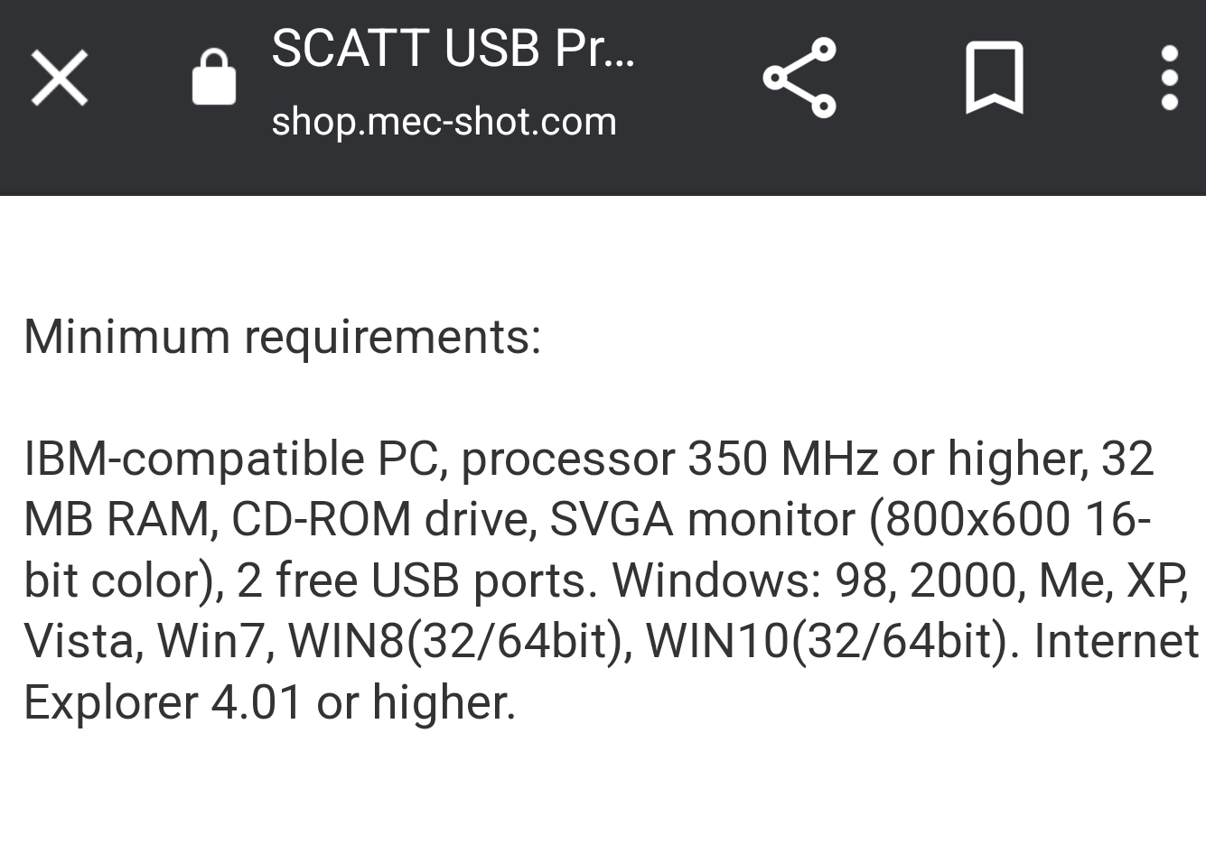

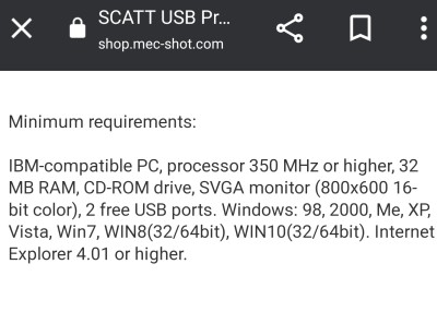

Pretty much any modern laptop or PC is capable of operating the Scatt software. I've setup 2 systems using sub-$200 laptops. Just make sure the selected computer exceeds these minimum requirements
https://www.scatt.com/downloads/
Replacing the existing laptop may not be necessary. The Scatt operating requirements are pretty minimal. It's more likely that there's a bunch of malware or other unknown/unwanted programs operating in the background. You might be better off updating the PC's security suite (anti-virus, malware protection, firewall) or taking it to someone who can.
Here's a link to the Scatt software and driver download links. Based on the Scatt USB manual, the Scatt Professional software should work. https://www.scatt.com/downloads/
