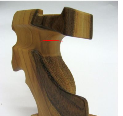

Does anyone have the width measurement for the material between the thumb and the trigger finger of a Pardini SP Medium size grip? Does anyone have this measurement for the large Rink SP grip?
This measurement:
Thank you!

Per calipers; per grip:
Pardini med bullseye: 1.358
Pardini med issf: 1.428
Rink Lg (LRB0d): 1.340 (on electronic trigger pistol)
Rink Med (MRB0d): 1.338 (on mechanical trigger)
Per pics (note: caliper readings shown in pics are jacked-up 'cuz I'm trying to gauge & take pic simultaneously):

Typically a place where light Dremel work is required to ensure the trigger finger does not touch the grip.
