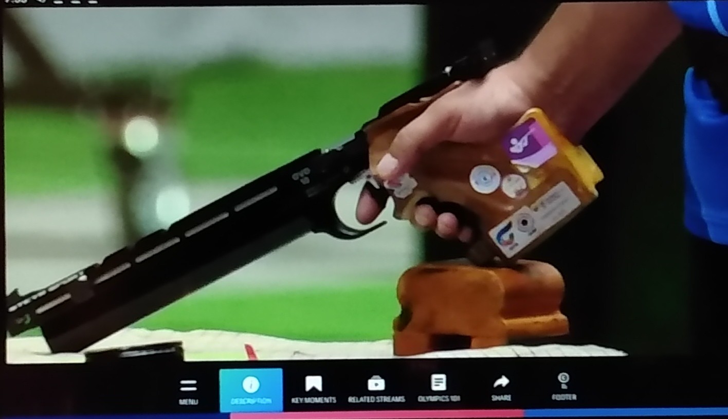

The men's gold medal last year was won with a Pardini, if I'm not mistaken

Which gold medal?PirateJohn wrote: ↑Wed Jul 27, 2022 3:43 pm The men's gold medal last year was won with a Pardini, if I'm not mistaken
The Olympic gold was taken with a Steyr, mechanical trigger to boot.

Didn't the Iranian shooter use a Pardini? Sure looked like one.brent375hh wrote: ↑Wed Jul 27, 2022 8:49 pmWhich gold medal?PirateJohn wrote: ↑Wed Jul 27, 2022 3:43 pm The men's gold medal last year was won with a Pardini, if I'm not mistaken

Nope. Steyr Evo M with an older Morini grip.PirateJohn wrote: ↑Wed Jul 27, 2022 9:00 pmDidn't the Iranian shooter use a Pardini? Sure looked like one.brent375hh wrote: ↑Wed Jul 27, 2022 8:49 pmWhich gold medal?PirateJohn wrote: ↑Wed Jul 27, 2022 3:43 pm The men's gold medal last year was won with a Pardini, if I'm not mistaken
