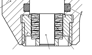

How do you adjust the spring pile in the LP200 regulator to 70-80 bar ?
I have to re-build a LP200 regulator with new after market Breville washers,
How do you setup, measure and test the pressure regulator ?
New regulators or spring washers are no longer available from Walther,
only O rings.
Adjustment is via the top poppet valve spring and the lower spring pile tension.

Some manufacturers (like Steyr) actually have a pressure gauge that the regulator assembly can be attached to. If Walther no longer supports the pistol with parts, it's unlikely they would sell you a gauge (if they had one).
As long as you understand how the orientation of the Belleville washers in the stack affects the force, you may be able to zero in on the right arrangement by experimenting until you get a nominal velocity out of the pistol. That assumes the velocity adjust screw hasn't been messed with. I imagine taking the pistol apart that far & reassembling it will be a royal pain.
You don't say what's wrong with the original washers. Some manufacturers use plain steel washers, which can corrode if you get a cylinder fill with moisture in it. Even if they are lightly corroded, they can probably be polished to work pretty close to normal. If you know the orientation of the washers in the original stack, one option would be to restack them, and place them on top of a stack of the new washers. Compress the double stack, and arrange the new springs until the deflections match. That will at least get you in the ball park.
As long as the dimensions, especially the thickness & initial "dish" of the washers, is the same, they should behave very similarly. You could start by just duplicating the original stacking. (I wouldn't trust the picture, it could easily be for illustration purposes only).
Good luck!

Thanks, it looks like being a trial and error job.
Failed O ring on the poppet valve, allowing the full tank pressure into the
pre charge chamber and flatting the origional washers left under load
for a long time and have lost most of their tension.

Ouch! That definitely limits your options. Short of prying info out of Walther on the washer specs, trial & error may be all you can do.
One other possibility is to see if they use the same part number washers in a different pistol The Belleville washer stack is pretty much an industry standard for these things. If they have the parts working well in one pistol design, they'd be silly to change parts for no good reason (although I've seen it done). However, if they used them in a newer pistol, I would think they could still supply them as repair parts.
