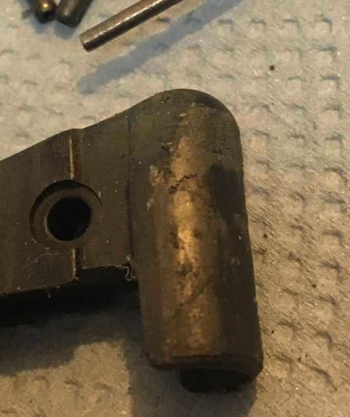

I was met with this when I took apart the magazine today, as well as a hard to see buildup on the inner walls of the magazines which I scraped off with a blunt wooden saté stick then got the rest with a thin toothbrush. I'll get to test tomorrow at the club, I'm thinking this might just be the issue. Magazines only ever got a minimal clean, so I'm glad I dismantled it. I can order a couple of new followers from Sweden, even when clean these aren't as smooth as I think they could be.
Posts: 3582
Re: MP90s last round issue
Yeah, that looks like it could be an issue...

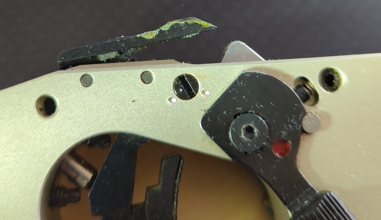

Indeed there are two lines on the bottom at 7 and 5 o’clock which the manual say to stay between.
I had put mine about 1mm to the outside of the 7 o’clock two years ago as it brought the trigger further back for me and felt great . And it ran fine for that time until a couple months ago.
I don’t believe it slipped as I had made a photo of it but it’s possible it was a minuscule amount. Bringing it back , right onto or a tiny amount to the right of the 7 o’clock line and within the lines fixed it but brought the trigger forward several mm which I’m getting used to.

Now you mention it, I adjusted that cam a few years ago and had some difficulties. Of course I don't remember the details now. Currently, the dot is aligned just slightly clockwise past the mark, say 7:10. I haven't touched the settings in years.
Your forward cam setting has a locking grubscrew? Mine does not, it has them only on the length and weight settings, behind the trigger.

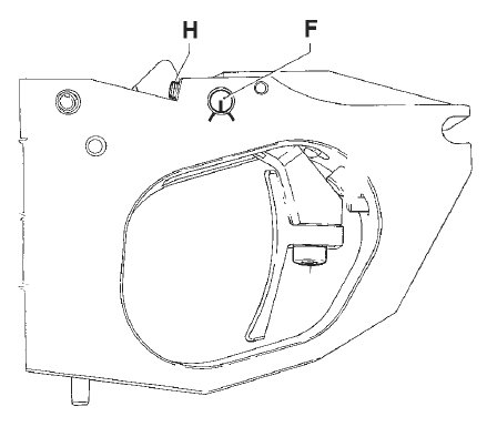

On the older ones, the locking grub screw and the marks are on the left side, not the right.
MP90S 1st Stage Length Adjustment Cam & Locking Screw.jpg (21.16 KiB) Viewed 3311 times
"H" is the grub screw.

D'oh! I see it now. Yep, on the right for mine. I did say I haven't touched it in years, right? :)
Because this cam adjusts the sear engagement, it is definitely possible to go too far - and doing so would cause the hammer to miss the sear and simply follow the bolt forward, unsafely.
