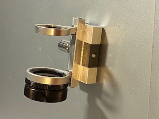

I am using the Centra version of this sight. I find several desirable features. The profile is smaller when looking thru the sights. Another way of expressing this, the thickness of the ring of the tunnel is thinner. The Centra Pure is height adjustable, using thin spacers. This allows an improved sight picture by having a thin post at the bottom of the insert and not the clunky black rectangular base. This allows a better circle within a circle.
I have used the Centra Pure on my smallbore position rifle indoors and outdoors. Reflections have not been an issue for me.
Regarding the fixed vs. adjustable issue, I like the thinner ring thickness available with the fixed style. It only takes a minute to change the element. A friend is experimenting with 1.0 and 1.1mm ring thickness with good results. The ring thickness with adjustable is usually 2.0mm. Yes, thinner ranges are available but I am not observing very many in use.
Using the spacers I can get a very good adjustment going from a 50 yard to 100 yard on my prone smallbore rifle. That way it is only a couple clicks and not 84. I remove one of the 2mm spacers that are shown in the picture. The black cap on the lens, in the left of the picture, is for protection from dust and dirt. It is removed for shooting.
Pure Profile.jpg (18.26 KiB) Viewed 2774 times

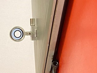

The below picture is a Level made by Centra. I have one here, more are on the way from Germany.
Pure with Level on Starik (2).jpg (29.15 KiB) Viewed 2774 times
I am also using one on my 300m position rifle. Again, no glare issues.
The empty ring hold the MEC Eagle Eye Change with the BaK4 GLASS front lens. I also use it to hold the Centra filter FS, which works well both when using a Suis type target or outdoors. The Blue in the front sight is a Filter FS. I use this when there is indoor lighting. I think it helps contrast.
Yes, some of the pictures are rotated, it is my photography skills ( Or Lack )
Hope this opinion helps..
MarkTrew

Revised Pictures for clarification.
MarkTrew
