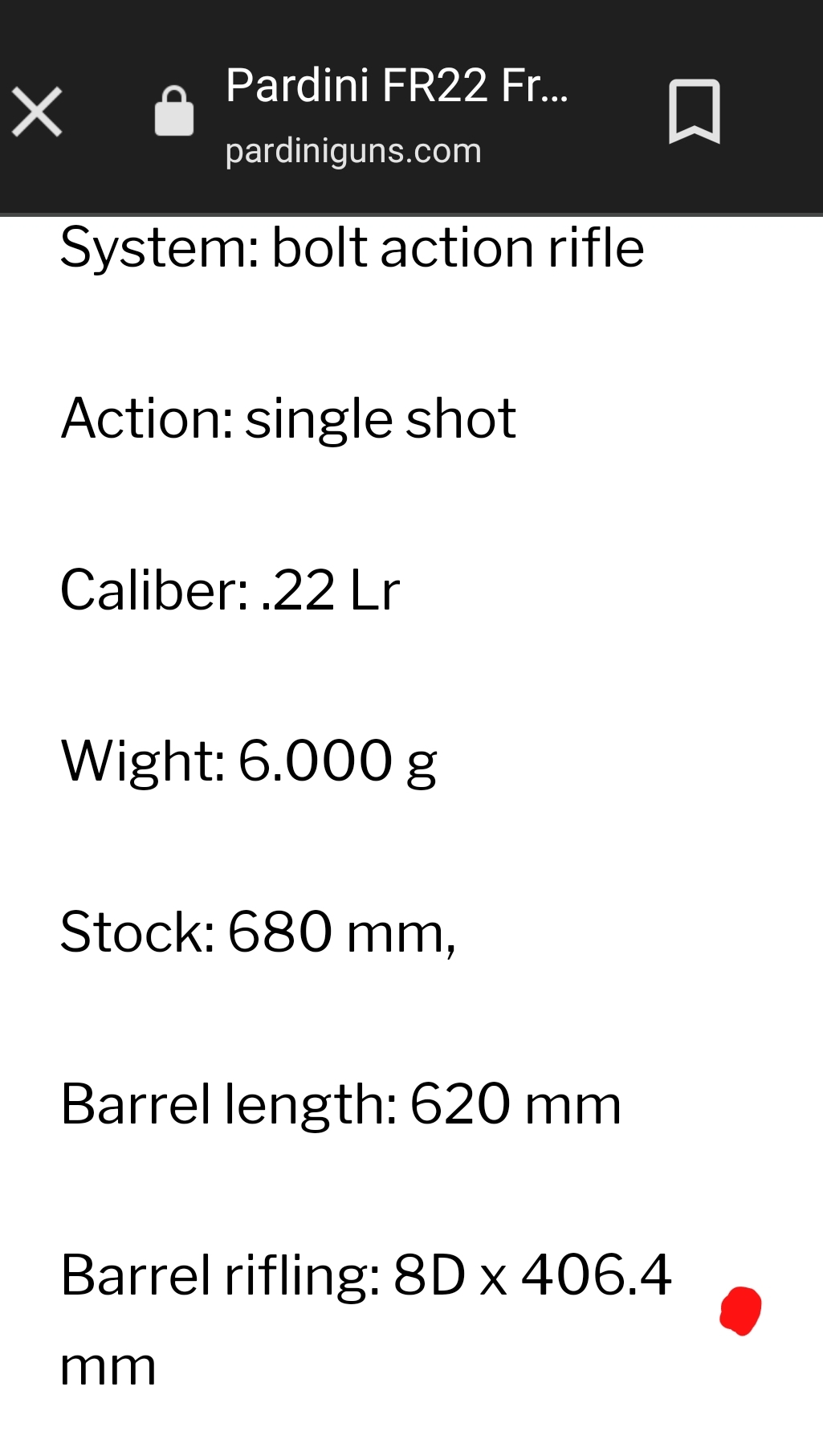

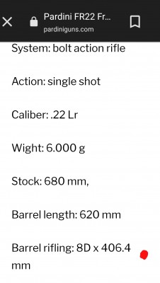

After talking with my coach, he expressed concern on the Pardini rifle webpage not providing much information regarding its specifications and having typos compared to the Walther KK500 webpage where you get a very good sense of its nuances. He noted how the rifling did not go very far in the barrel leaving a reasonable length of non-rifled barrel length.

Where do you get the idea that the barrel isn't rifled all along*? Are you mistaking the rifling pitch for rifling length? The technical specs list 406.4mm (16in) against the rifling, and 620mm (24.4in) overall barrel length. 406.4mm isn't the length of the rifling, it's the just the twist, ie the distance the grooves take to turn 360°. The same entry also lists the number of grooves. It's normal for the twist to be shorter than the barrel; the grooves turn more than once. Take the Anschutz 1913: a 16.5in twist in a 27.2in barrel.

That makes much more sense.Where do you get the idea that the barrel isn't rifled all along*? Are you mistaking the rifling pitch for rifling length? The technical specs list 406.4mm (16in) against the rifling, and 620mm (24.4in) overall barrel length.
