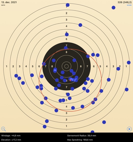

Hi,
I am a former archer, but an injury a couple of years ago has made it impossible for me to continue to shoot with a compound bow.
But I miss target practice, and since I always had a fascination for pistol shooting, 10m AP seems like a good match.

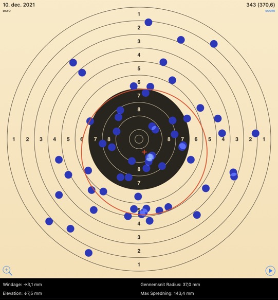

I have set up an 10m indoor range and tried to shoot a 10x6 series a couple of times. The results are posted below.
If You see something obvious with my shooting feel free to comment - I am here to learn!

Regarding your groups, they should shrink in size the more you practice and build up your arm and upper body strength.

Hurtigpelikan wrote: Mon Dec 13, 2021 2:47 pm If You see something obvious with my shooting feel free to comment - I am here to learn!
I'm in week 11 with 10mAP - your targets look familiar and mine were very similar. Lots of decent information here so keep you eyes and ears open. I also set up a small range at home, but I'm also told it's important to vary where you shoot.

I'm not so sure you are jerking the trigger. A jerked trigger usually goes into an 8 o'clock area, not high right. You might be gripping at the moment of trigger release, that usually will go up and right. Watching your front sight when dry firing is the key to finding if you are doing something that disrupts your hold at the moment of trigger release. If you don't think you are gripping, perhaps all you need is a sight adjustment. If all your groups look like that, coming down would eliminate your 7s.

Your targets show that you are all over the place. It's pretty common in new shooters so don't worry too much about it.
Without seeing you shoot, it's very difficult to diagnose the problem (probably problems...).

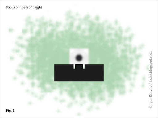

1- Where is your focus? Target, front sight, rear sight?
It must be on the front sight, like this:
2- What happens to the front sight when you break the shot? Does it move?
3- This is just a guess, but you are probably gripping the pistol too hard, trying to make it stop wobbling.

- Focus on a good sight picture as the one above. The rear sight will be a little blurry, and the target a lot blurry.

Excellent advice from both brent375hh and rmca, and I'm sure others will add to this.
Hurtigpelikan..............see what I mean !
