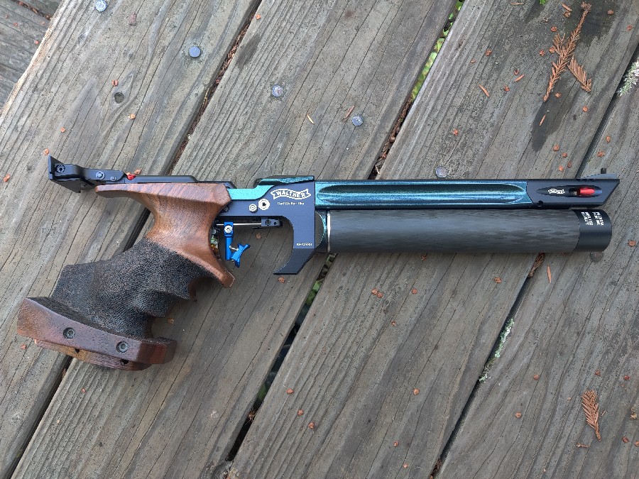

I just used a stippling point on a soldering iron to re-stipple the grip of my air pistol. The blackness comes naturally when the texture is burned in.

This is true. Boiled linseed oil seems to be a safe standard for that sort of thing. It's what I use in all my guns.
As a reference, I attached a photo of my newly stippled AP. I'm pretty happy with the results.
