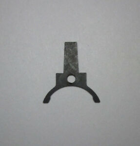

Is the sliding mechanism smooth and locks back normally when tilt downwards or cocking the pistol? Has the pistol been broken-in with the new seals/spring(s), does the pistol group, or the shots that are shooting high scattered?

Did the pistol have this problem before you had the full service done?
Is the front sight blade insert standard or the tall version?

The break-in period with new seals and spring(s) should be around 50-100 shots, if it continues to shoot high, you can use a tall front blade insert to lower the muzzle.
As long as the pistol groups well, learn how to shoot with the sub-six hold.
FWB tall front sight blade insert.jpg (6.5 KiB) Viewed 2895 times
