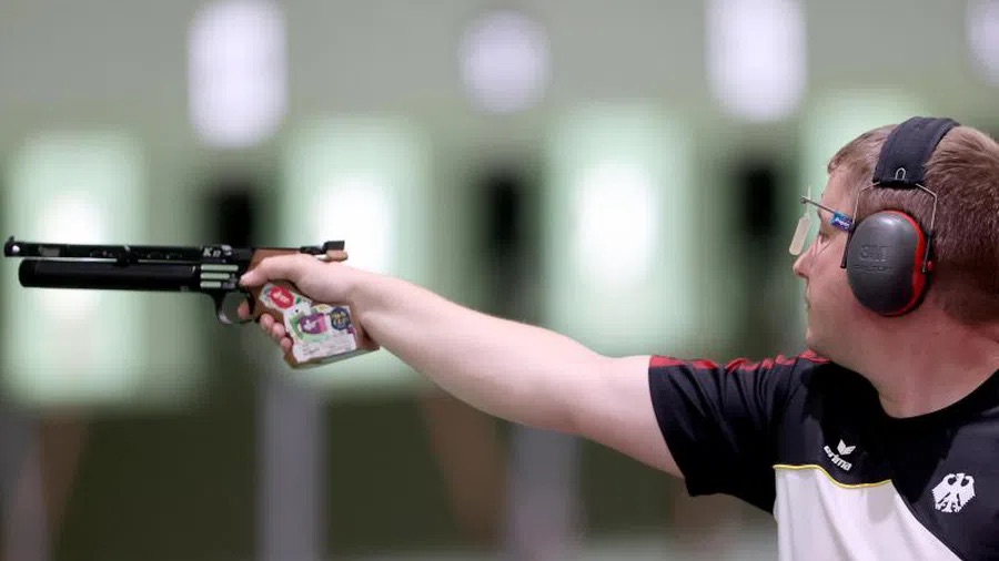

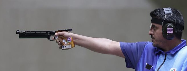

I know that this subject has been visited a few times but, despite the other controversy swirling around Javad Foroughi, surely his grip cannot be legal, or Christian Reitz's for that matter.
My Rink grip on my FWB P44 doesn't come anywhere near covering my wrist joint like these two.

Wow that is a very high grip indeed...BUT surely they would have all gone through scruntineering prior...??
Or...maybe they didn't.

The fact that a good number of high level shooters seem to glue about an inch of timber onto the back of their factory grip might tell us something.
The "but they've been to X international matches with that grip, we can't question it now" is a stupid one.
I don't think I've ever seen anyone asked to put their hand in their grip at EC, except for rapid in the old days.

I've had the wrist and grip checked at some competitions, together with shoes, glasses, and fitting the pistol inbthe box. You have to hold the pistol like you would for shooting and show you can bend the wrist downwards (adduction). Yes, the palm shelf touches the wrist bones at some point for most shooters but it does not impede movement, you still have to lock your wrist eith your muscles. Every once in a while someone will go a bit too far and be asked to file it down. It is definitely something that could be better explained in the ISSF rules.
Ramon (ISSF pistol coach C)
Re: Olympic Pistol Grips
The problem for Equipment Control, is there is no definition or exact point for the "wrist".
Hence the best they have is a movement test, although even this is not in the rule book.

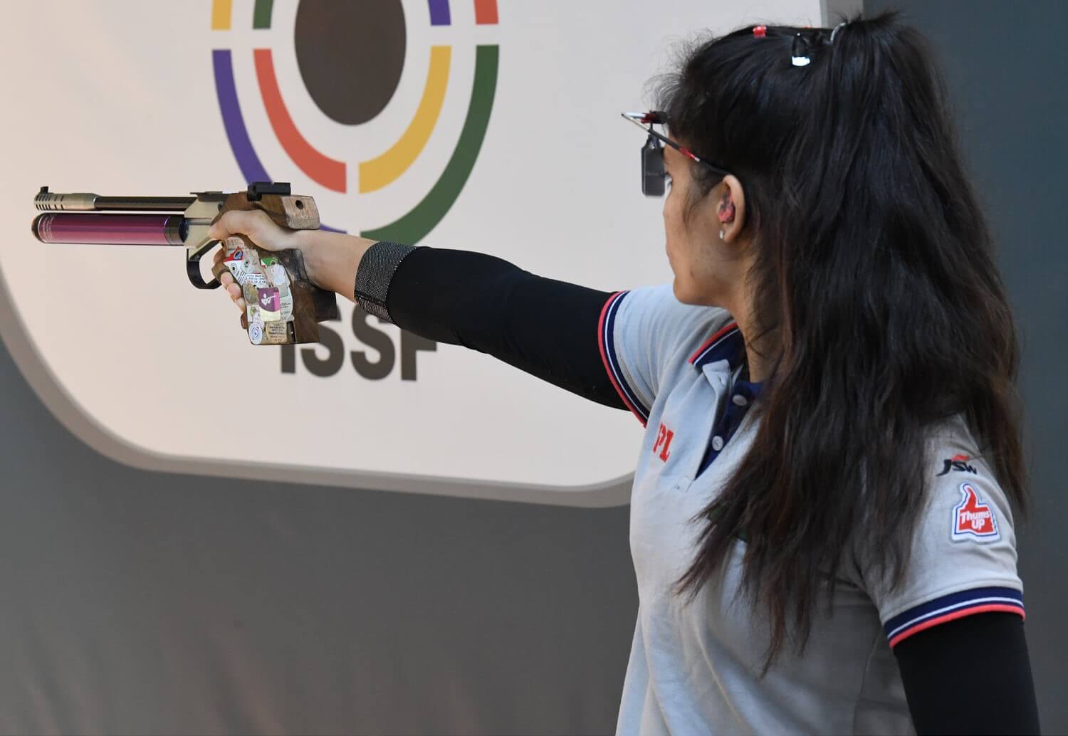

I think that some shooters sail very close to the wind but I guess EC and the judges must pass them.
Manu Bhaker of India at the ISSF President's Cup at Wrocław in Poland.
