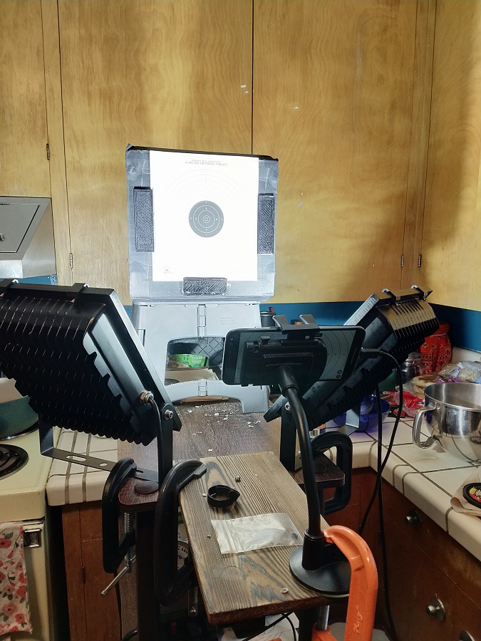

I've posted it on here before but I've had a lot of similar issues with being able to score targets once my groups started turning into a big hole that new shots could pass through.
I set up a target camera using an old smartphone running security camera software, with a monitor by my shooting stand showing the actual hits on a 2-3 second delay. Now I can shoot, watch the hit, and record each shot one at a time. I very rarely lose track of a shot now, and I get instant feedback every time.
I do plan on buying an electronic scoring target at some point in the future, but in the meantime, my current solution cost me nothing.
UnGe
Posts: 166
Re: Home range targets
Post by UnGe »
McMadCow wrote: Tue Jun 08, 2021 5:55 pm I set up a target camera using an old smartphone running security camera software, with a monitor by my shooting stand showing the actual hits on a 2-3 second delay. Now I can shoot, watch the hit, and record each shot one at a time. I very rarely lose track of a shot now, and I get instant feedback every time.
Nice idea. Would you mind sharing details of the set up?
McMadCow
Posts: 174
Location: SF Bay Area
Post by McMadCow »
UnGe wrote: Tue Jun 08, 2021 7:55 pm Nice idea. Would you mind sharing details of the set up?
Sure, it's a pretty easy setup.
-Pellet Trap
-2 Lights
-Old Smart Phone
-Monitor
I have my smartphone in front of the pellet trap. I'm running a security camera app that uses the camera. I use CamOn, but any IP Camera or ONVIF app will work. Then to view it, you just need either a security camera viewer app (IP Cam or ONVIF) or you can just point your browser at the IP address and port number that the viewing cam is broadcasting on. For my setup in my place, I have an old monitor with a Roku attached to it. As luck would have it, there's an app on the Roku library that views IP cams, so that's super easy.
Because of the protocol, the feed is probably 2 frames a second, on a 2 or 3 second delay. So I can shoot, look over at the monitor, and see the impact. I basically never lose track of shots and because it's magnified I can be very specific. I'd have to go to 5 shots per target for scoring if I didn't have the target cam setup.
I do want to buy some proper electronic scoring target at some point, but I've been really happy with my current system. Being able to do accurate scoring is great, but the best part for me has been the instant feedback.

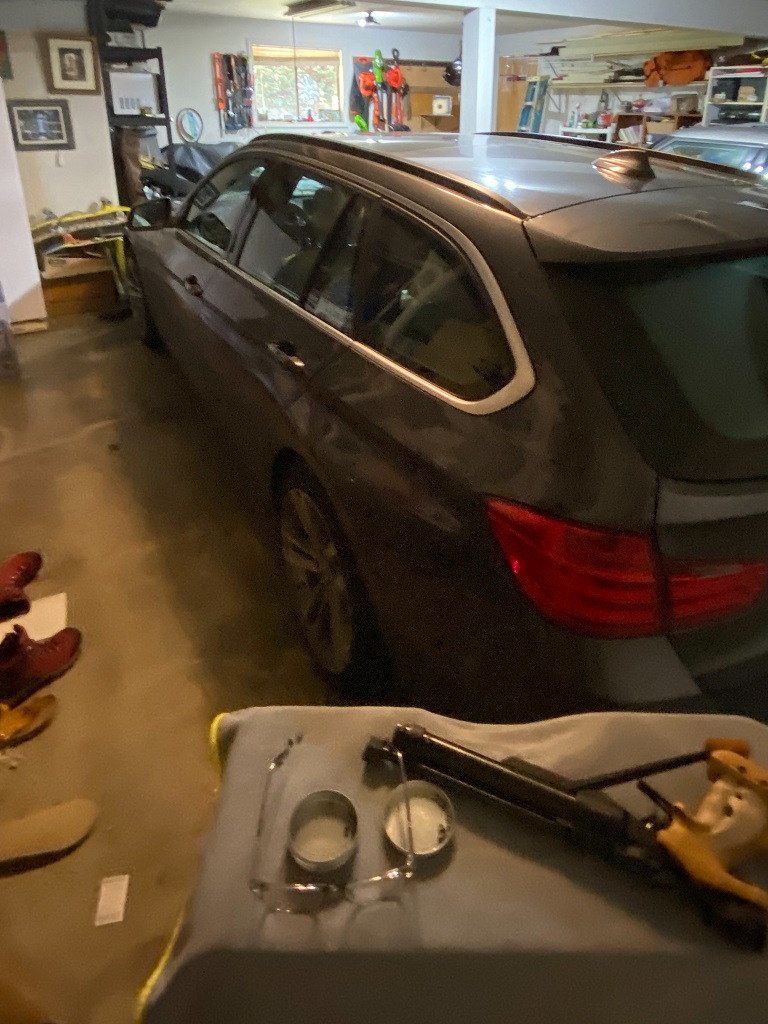

UnGe
Posts: 166
Post by UnGe »
Very nice!
Let extend this thread to showcase not as nice as yours, but ugliest home set ups. I hope I'll win the contest!
(For my picture it is also a puzzle "find the target")
B Lafferty
Posts: 459
Post by B Lafferty »
UnGe wrote: Wed Jun 09, 2021 9:18 am Very nice!
Points added if you shoot through the vehicle.......
