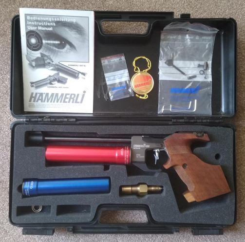

A successful swap with both parties happy about the transaction.
Thanks again guys for your views on this pistol, there's not a lot of info anywhere for these pistols so your take on things (along with another helpful chap's input) swayed me into having a punt on this little known gun.
