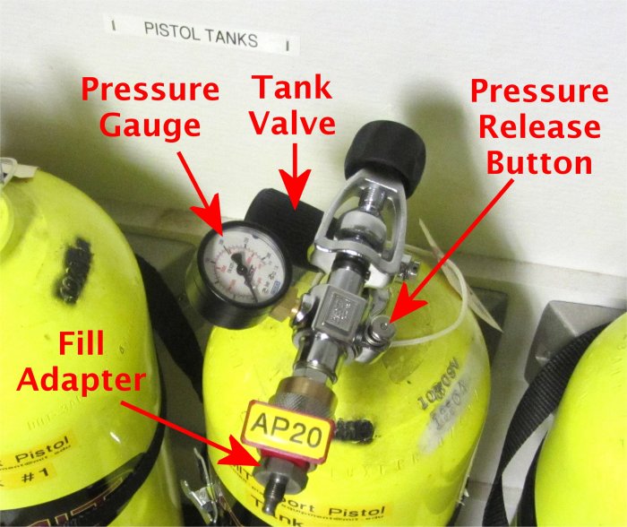

Yes I am over thinking this. I just want a bleed valve. No, I haven't needed one in 7 years, but I like new things. The Best adapter with a bleed valve straight into a DIN fitting, custom assembled to my inquiry, filled that New Thing want. Once I dealt with Sam at Best, I felt it was money well spent.

If you look up the the second post by GWhite, there are two links. I have the fill adapter with the female DIN fitting directly screwed on it without a hose. To me, the hose is just another thing that has to be bled and uses up air needlessly.Azmodan wrote: ↑Thu Mar 11, 2021 4:05 ammaybe put a picture with the new device, so we can see the end resultbrent375hh wrote: ↑Wed Mar 10, 2021 8:40 pm

Here's what I think his setup will roughly look like. The team I help coach has three tanks with the Best Fittings gauge & bleed valve adapters set up for different air guns. Our tanks have K-Valves instead of DIN:
This one has a Hammerli AP20 fill adapter installed in the female DIN. I 3D printed label holders to identify which adapter is installed.
