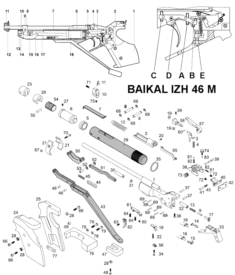

Lenny, I don’t see any adjustable screw on the diagram
https://images.squarespace-cdn.com/cont ... rmat=1000w
51 attach to 54
Screw 27 tighten/ loosen piston? I don’t see how THAT screw would do to piston tension besides holding 54 and 6 from going apart.
Which adjustable screw are you talking about?
Screw 54 in and out of 6 to adjust lever tension?
That is how you adjust 46M velocity, too?

Post by Lenny »
Part 54 turns into Part 6. That's the adjustment.
Part 27 is the screw that locks the adjustment.
In my initial instructions "screw" was used as a verb.
I also thought this adjustment is to adjust the velocity (pressure in the cylinder). I no longer think so.

Are you just saying that your lever won't stay up, and drops down too easy?
If so, replace spring 45 with something a little stiffer, or add a spacer for preload.
Spring 45 pushes on the plunger latch 44 that cams the lever up into the tube. Ignore me if your problem is something different.

Post by seamaster »
Just doing some Richard Feynman deductive inquiry into my "Houston, this is an obvious major malfunction" problem.
https://images.squarespace-cdn.com/cont ... ormat=750w
That 51 bar on 46M is linear-curved-linear, but on the pistol diagram on top (46, not 46M) it is a straight bar. I think that circular bend on 46M must have weakened, that extra weakened circular bend must have pushed the handle closure downward, preventing it to full close at the end of pumping.

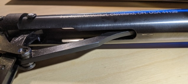

seamaster wrote: Mon Feb 22, 2021 5:59 pm New AV-46 from Air Venturi has a straight bar or a curved bar?
The AV-46M has a bar like the one in your linked diagram, it's straight on the ends and curves upward in the middle. The reason for the curve is so it doesn't contact the slot in compression tube as the piston moves rearward.
To me, it sounds like the piston was "bottoming out" which caused the pistol to resist being fully cocked. This also may have added stress on the compression link #51.

Here are a couple of AV-46M photos for clarity:
The compression linkage, showing the "bend":
And showing the clearance at the bend, as the pistol is cocked about halfway:

Post by Lenny »
IZH-46 had #51 as a straight bar. This is what is shown in the illustration above parts diagram. When this pistol was redesigned into IZH-46M with longer compression chamber, #51 had to be
made longer, but longer straight #51 would jam into the end of a slot during cycling. They had to put in that curve into #51 to clear the end of a slot.
That curve made #51 literally the weakest link. I suspect yours was already cracked which was the reason the lever was not locking in place.
There was no way to get #51 from anywhere. I searched for it, even asked the guy from Russia who sells IZH-46M parts on ebay. He said he will try to get someone to fabricate it, but nothing came out of it. European American Armory has a good supply of IZH-46M parts. They told me, there is no way for them to get that part because of the sanctions. They are aware of the demand for that part.
