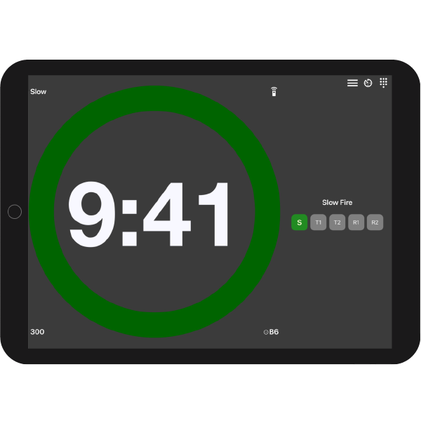

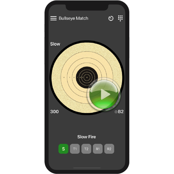

Bullseye Match performs the range officer operations for a course of Precision Pistol. It plays Prep, Slow fire, Timed and Rapid fire range calls for a "300" Gallery or full "600" or "900" Aggregate relay. It is designed to be simple and intuitive for shooters. It can be used for training, timing, or to run an entire match.
Tapping the target plays each string, and the match moves forward automatically. The calls play with regulation timing, followed by the start signal. It counts down the time, plays the stop signal and closing calls, then advances to the next round. If you finish early, tap the target to finish or cancel the round. Another tap begins the next relay, until all stages are fired.
Buttons indicating the upcoming round can be used to skip, replay or change the sequence manually. The buttons will slide to display the match clearly and make selection easy. Timer functions are available for self-timing, drills, and match preparation.

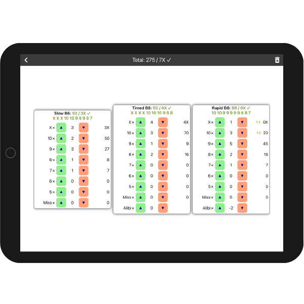

The app also provides a scoring calculator for B2, B3, B6, B8 and B16 targets, with ring scores, X count and Alibi corrections. It can capture photographs of scored targets, watermarking them with the date, time and any scoring information.

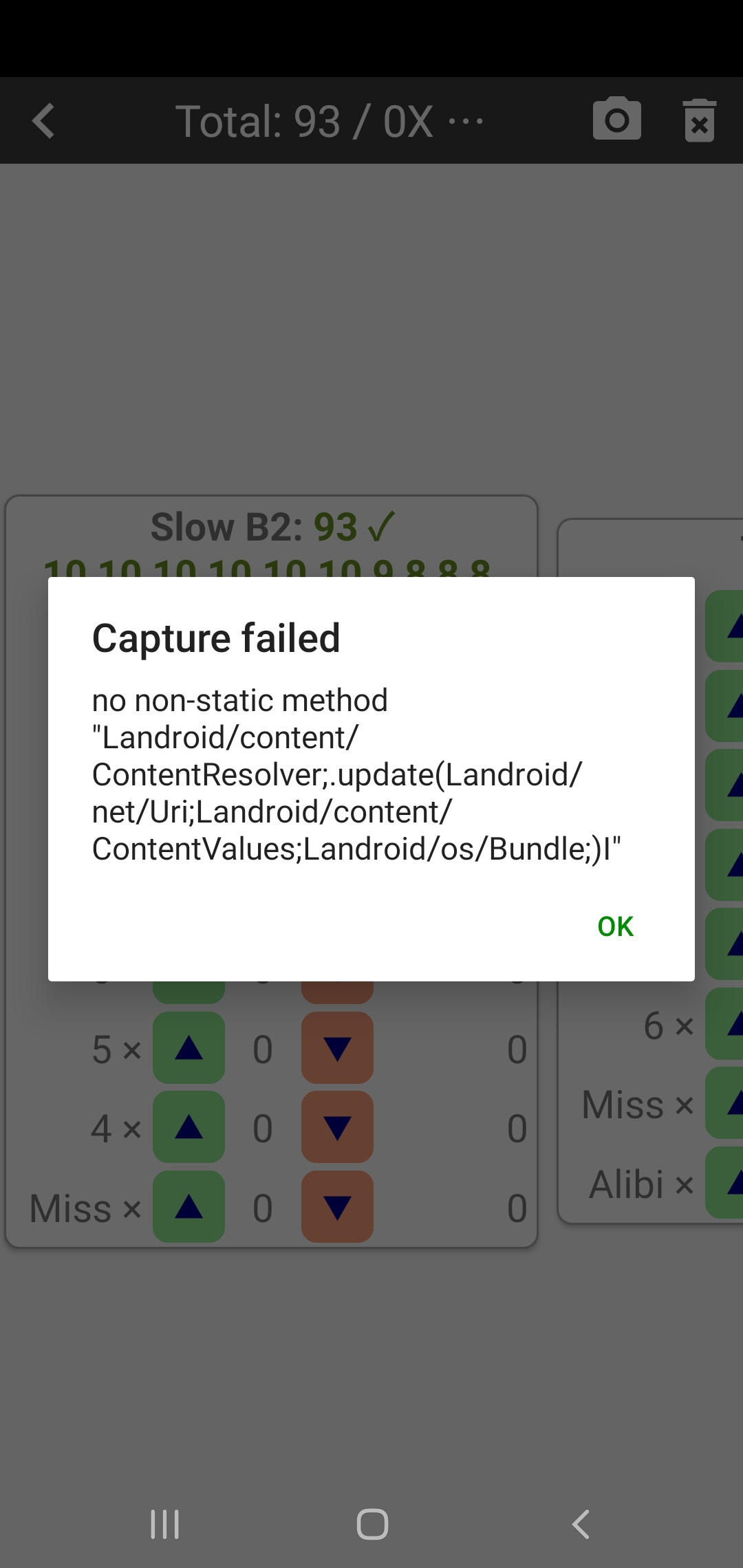

Below is the error I get when trying to take a picture of target

robjob wrote: Fri Dec 04, 2020 7:30 pm Below is the error I get when trying to take a picture of target
Hmm, that's coming from the OS. Sending you a PM for more details. Thanks!

Thanks for the further info - looking into this some more, I think the picture is actually being taken and saved successfully, but the step of publishing it in the phone's album is failing. It may have to do with some Samsung-specific feature, or of course it could be my app too ;)
If the picture isn't visible in the album, it may appear later - possibly after taking another photo. I'll see if I can find a better solution, in the meantime. I'm actually working on a new "export" feature, so stay tuned.
[edit] I've reproduced the issue - it is specific to Android API 29, aka "Android Q". On Pie and earlier, a completely different approach is used. And on R and later, the existing code works just fine. I'll have to update to fix this, unfortunately. But I'm sure you will like the new export, once it's ready.
Thanks for the report!

Fixed photo save failure on Android Q
