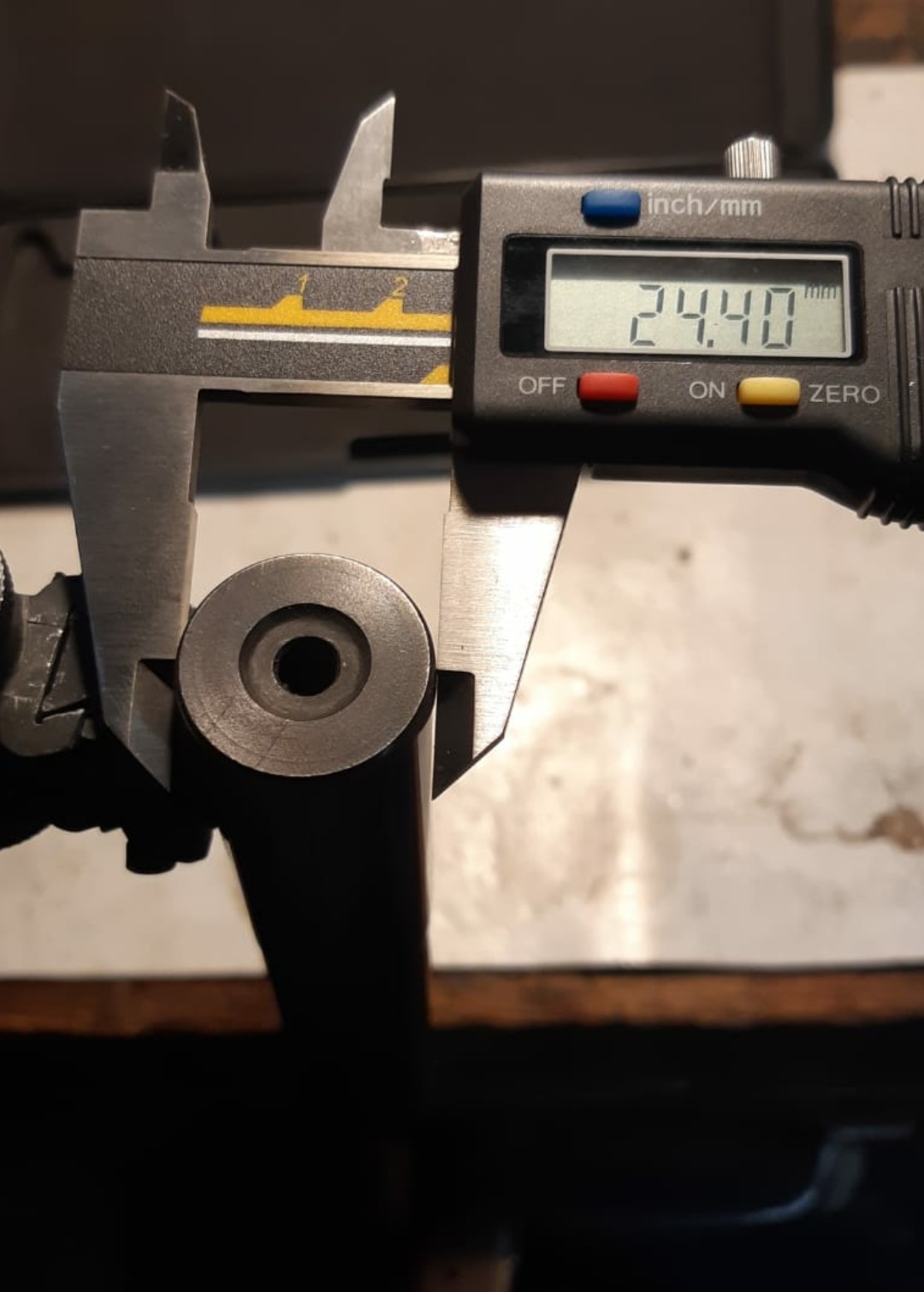

Hello all,
Technical question about my rifle.
Do any of you happen to know the barrel diameter of an Anschutz 1413 ( circa 1974) ?
I’m considering a tuner and I unfortunately do not have a micrometer readily available. The length appears to be 27 1/4” and my handy dandy ruler shows the barrel tip to be just a hair under 1”. I just want to be exact for the order.
Thank you in advance.

This may not be what you want to hear, but you really need to measure your barrel, not rely on someone else's.

Yeah, I figured that might be the case.
Just thought there was a “standard” measurement for stock barrels. Trying to avoid having to go buy a micrometer. Thanks for the reply, it’s appreciated.

Dont buy a Mic, Buy a digital Caliper...... 10 bucks at harbor freight, its good enough

Mine one measures 0,96 inch, 24,4mm.
But is better to measure your own barrel.

you buy a cheap measuring tool, chances are you'll get an erroneous measurement.
find someone who has a quality tool because,
if you're off by a few thousandths, it won't fit (don't ask me how I know this).

I didn’t realize that calipers/ micrometers were that inexpensive. I’d never looked for one and just had it in my head they were upwards of$100.
Thanks again for the quick replies, advice, and Devi for the pics. Looks like I’m off to the store.
