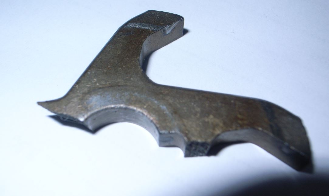

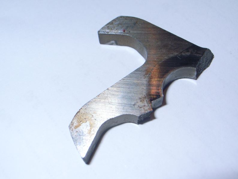

Would anyone like to hazard a guess what this is, or what is it from?
The mystery part looks finely made, has a "straw" type finish, is a broken piece from a larger part and inspection of the "break" shows it's from a casting, or MIM part.
I just found it on my garage floor, where my reloading bench is.

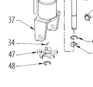

Almost directly above the spot where I found it, I have a Hornady LNP AP mounted. A quick look at the schematic doesn't show anything that looks like it.
As a matter of coincidence, I have another Hornady LNP AP mounted to the left, and the shell plate carrier on this one has stopped rotating - which I still have to investigate.
Again, nothing looks similar on the schematic.
Thoughts? Wild guesses?

Its part 47, and the reason your press is not rotating
http://www.manualsdir.com/manuals/54634 ... original=1

Now look for the other piece, suggest starting with your car tyre.
