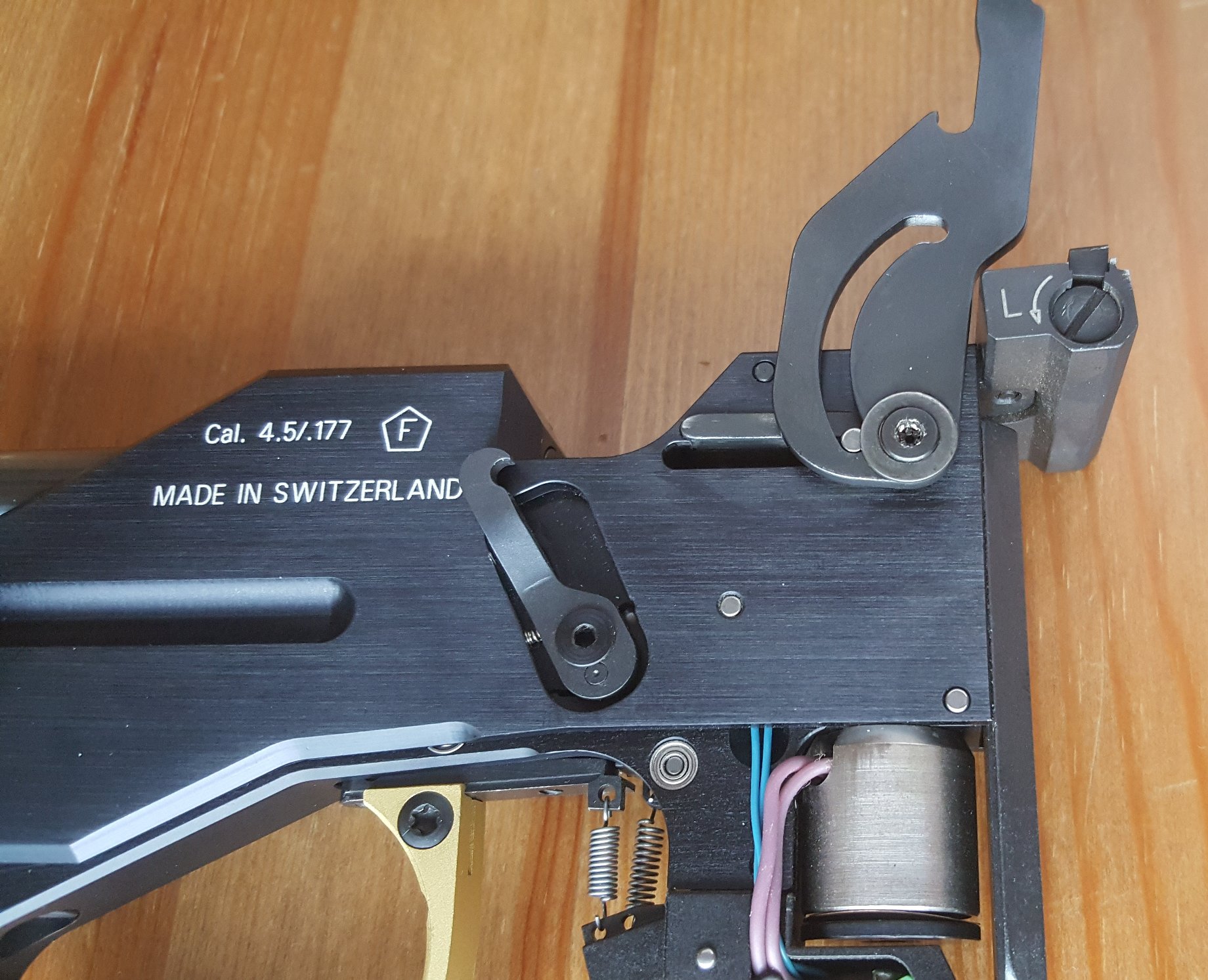

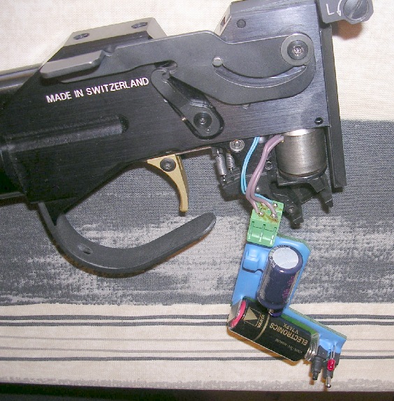

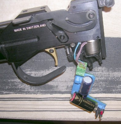

Take the grip off remove the electric trigger system in the grip. Used a can of compressed air for computers and blew out everything, especially while moving the lever up and down. Also used some 90% alcohol on Q tips and cleaned everything I could reach.
If you have a Morini MC162el, they are really easy to work on. I was really worried about the electric part in the grip. They are almost fool proof, they plug in just like adding memory sticks to your computer.

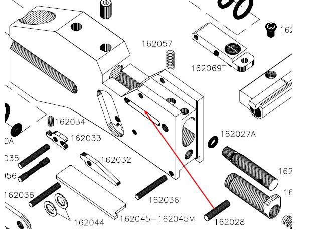

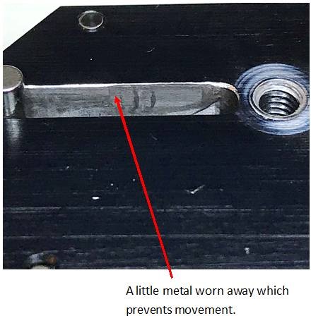

Part 162028, the dowel rod which connects the bolt and lever, can wear a slight grove in the slot it moves through.
I emailed Morini about it and this was their reply:
"the problem concerns the sliding of cod.162028, we have to work about 0.2 tenths of a millimeter on the window (part above) to align the surface.
if you can, send us the air pistol without grip, barrel, trigger and electronic unit."
You can use fine grit sandpaper or a file to work the area. I used a disposable nail file. I then used a very tiny amount of M-Pro 7 LPX synthetic gun oil. This may not be the best thing to use to lubricate the area, but I have had no problems with it. I figured it was safe for lubricating the aluminum on aluminum area. Just don't get it on the bolt. You can use a Q-Tip and put a drop of oil on it and move the Q-Tip through the slot. Once I did that I have not had a problem in more than 10,000 shots. If it gets stuck again, just re-lubricate the area.

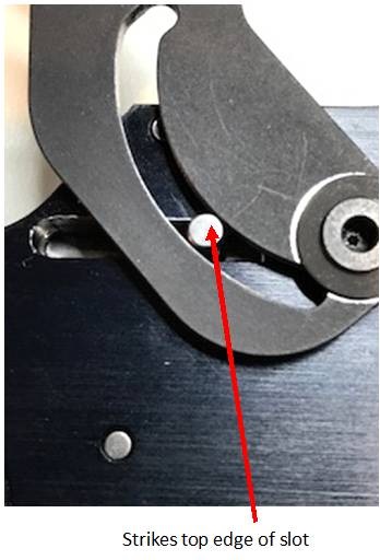

Slight surprise here ... It seems they changed the design at some point. On my gun, the pin #162028 is rubbing against a small removable piece of metal.
My gun has a serial number ~15800, which might mean it was manufactured in approx. 1998-1999 (wild guess).
Anyway, since the loading lever screw (#162038) looks more or less completely trashed, I tried to clean and lube the pin and slot without removing the loading lever. I used an *extremely* small amount of graphite grease and it did seem to help. However, already after 70 shots, the mechanism had become slightly less smooth, so I think I'll try to add some more grease.

I have been having a similar problem with my CM162 for some time now. I am asking for information which surface should be sanded the entire window surface marked with a yellow outline or only where it is uneven (right side of the window)?
Re: Help My New Morini mc 162el has a problem.
The underside of the frame slot is the galled surface. On opening the hardened pin isliftedto slife aft scraping on the underside of the frame slot.
This is the surface to dress.
Strip the pistol down and remove the arm,pin and loading bolt.
Use a fine needle file wrapped in 320 W&D, then 600 and 800 grit wet with light oil to a polished finish.
Clean well and re-assemlbe.
Lube pin & slot only with some moly grease.
Do not lube loading rod.
On one very badly worn frame I have had to machine out the top of slot and insert a hard steel sliding surface to repair.
