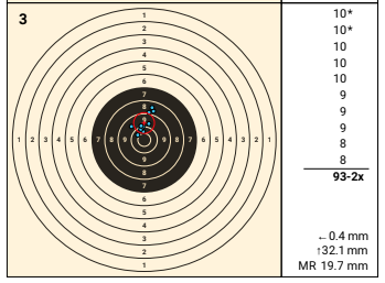

Hi David,
I'm shooting a Walther GSP Expert. Using Lapua Brass with 1.5gn WST and (previously) 98gn .314 Blackwidow projectiles.
This is my best group at 1.5gn from a ransom rest.
Screen Shot 2018-04-22 at 2.57.38 pm.png (49.49 KiB) Viewed 7633 times
This is using projectiles that I have individually weighed and are the same weight +/-0.1gn. If I use a random selection of projectiles the weights vary and the group extends out to the 8 ring.

Re: 32cal Projectiles - Australia
Out of intrest, bullet pull one of your loads and measure the bullet diameter.
Measure top, middle and bottom of projectile.
Compare it to a unloaded new projectile.
This will tell you what your dies are doing to the bullet during loading.
If you are loading .314 with unmodified dies I bet that the bullet will
measure undersize.

What distance is this?
What distance is this from?
