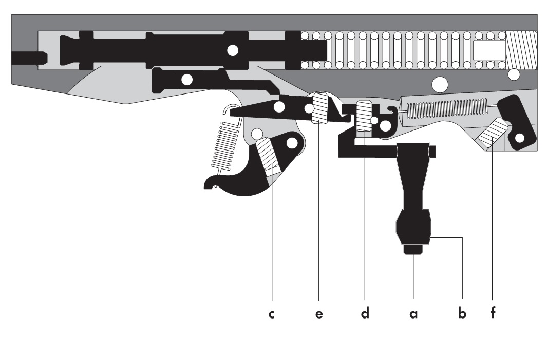

"Trigger power" (screw f in the manual) is actually the first (1st) stage trigger pull weight. (the most rearward screw, pointing diagonally forward).
"Trigger Pull" (screw c in the manual) is the second (2nd) stage trigger pull weight. (the most forward screw, pointing slightly to the rear).
see attached picture.
Albert T
(The Netherlands)

Albert, thank you for your post and time.
As you seem to be someone that is familiar with the LG300 specifically, and should you return to this post, perhaps you could further help me. I am happy with the first and second stage trigger pull weights, as I am with the first stage travel. What I do want to adjust is the second stage travel, or as was previously stated, its "crispness." I find it just a hair mushy. So my question: which screw or screws would I use to make that adjustment and in what suggested manner or inter-play? I am assuming that would be the screw (e) in the diagram. The manual states, as you probably know, "with the trigger cocked the screw is slowly turned clockwise until the gun shoots. Then turn anti-clockwise 1/4 to 1/2 turn." Is this turn anti-clockwise 1/4 to 1/2 the adjustment range? Does your experience support that? And would the 1/4 or the 1/2 turn provide less travel (more crispness)? In other words, does the second stage become crisper or less crisp the more I turn anti-clockwise?
Should you get back around to this posting, thank you in advance for your help. Becuase of a lack of experience adjusting triggers, I just don't want to start turning screws and make a mess I can't find my way out of.

Posts: 2105
Re: Some Help understanding Trigger Adjustment
No, the 1/4-1/2 turn isn't the adjustment range. The manual is telling you to reduce sear engagement (your 2nd stage travel) so much it can't hold the pressure. You then increase engagement just enough that the trigger holds, but is still super crisp. 1/4-1/2 turn is the safety margin for crispness.

Tim S wrote:No, the 1/4-1/2 turn isn't the adjustment range. The manual is telling you to reduce sear engagement (your 2nd stage travel) so much it can't hold the pressure. You then increase engagement just enough that the trigger holds, but is still super crisp. 1/4-1/2 turn is the safety margin for crispness.
Thank you, Tim. Then it sounds like I need only concern myself with the adjustment of the sear.
