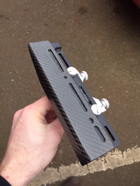

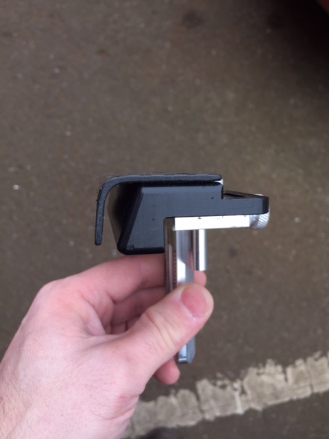

I had the same problem and glued a TEC-HRO cheek piece on that I already had (see attached pis). You can buy them separately from their website:
https://tec-hro.de/schiesssport/en/benc ... arbon.html
Works a treat as I prefer the highly polished finish and curvature.
Hope this helps, Bryan
