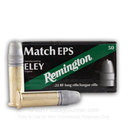

My first target pistol was a HS Victor. CCI SV also would not chamber in my pistol either. AT that time, I was using Remington Eley Match and it functioned perfect and was an X ring gun at 50 yards with that ammo. I didn't ransom rest it, but it was as accurate as my new Pardini at that time.
I had to do what was suggested by many at that time, which was find an ammo that works in that particular gun. Just because this Remington Eley Match worked in my Hamden HS Victor, does not mean it will for others. These 22's can be fussy.
Because this Remington Eley Match worked so well for me, I suspect that the Eley brands of ammo all would have, but who knows. This is the EPS shaped projectile.
