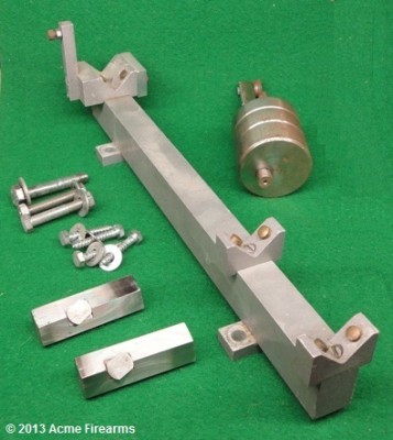

I've also found an online pic of what is labelled as an original Kudelin that I thought would be interesting to share:
Kudelin test rig
Kudelin test rig

Posts: 2094
Re: Commercial .22 test rigs
Pete,
I think the HPS and Gemini have a vertical post, like the one at the back left on your picture, to prevent the rifle tipping over, when using the stock and fore-end bar.
PeteJ
Posts: 31
Joined: Mon Apr 07, 2014 5:13 pm
Location: UK South
Post by PeteJ »
Thanks Tim, I think that must be, although it seems a bit hit and miss to let the stock/post interface interfere with a lateral force by leaning the rifle onto it. I like the look of the vertical post under the EPS better, as it seems more repeatable and balanced.
