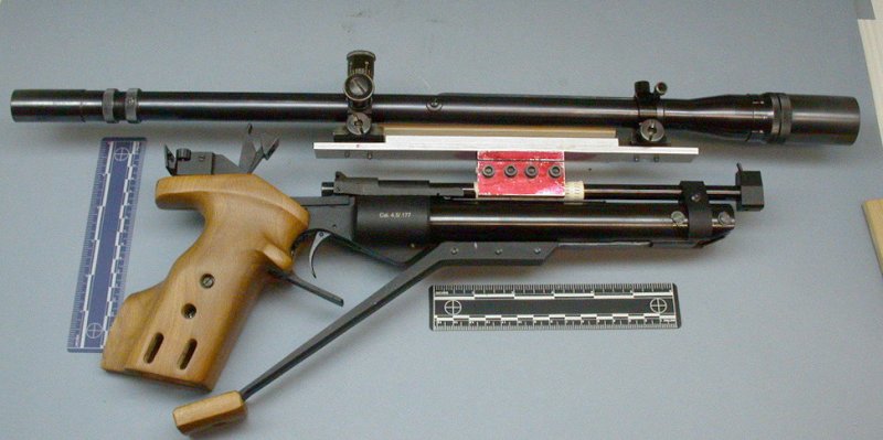

As we age, scopes are more sensible for shooting horseflies and yellow jackets in the backyard. Here's a decent horsefly gun. I have since added a shoulder stock.
IZH 46M with Unertl 8X .jpg (52.51 KiB) Viewed 1636 times
Posts: 7079
Re: Loading a SSP question
A lovely example of the "kludge."
