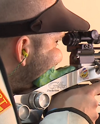

Niccolò Campriani in the Rio 50m prone final,using an unusual cheekpiece:

andrewp wrote:Niccolò Campriani in the Rio 50m prone final,using an unusual cheekpiece:
I think he has taken inspiration from his girlfriend Petra Zublasing, who has used even more minimalist designs. She did rather well with a Walther Anatomic stock and no cheekpiece! She balanced on the curve of the butt, seemingly with very delicate pressure. In his commentary of the 3x20 at the 2013 WCF Henri Jungaenel observed that she'd taken off the cheekpiece and seen her scores rocket.

Very interesting photos of Campriani. Looks a bit uncomfortable but well done him for making the effort. I suppose that this is an example of the expensive, high-tech additional equipment that currently so worries the ISSF and puts people off target rifle shooting?

Cumbrian wrote:Very interesting photos of Campriani. Looks a bit uncomfortable but well done him for making the effort. I suppose that this is an example of the expensive, high-tech additional equipment that currently so worries the ISSF and puts people off target rifle shooting?
Exactly! Just look at the effort he's putting into the "arms race" - imagine if he would simply put all of his effort into training & physical conditioning!
