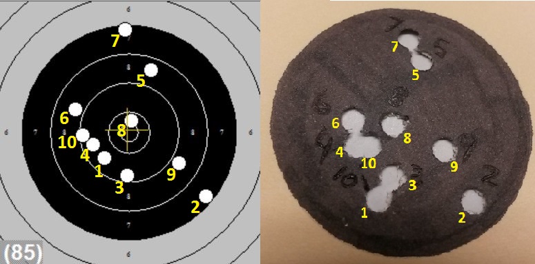

When I got the SCATT I set the F coef to 25 for 10m air pistol based on the gunsnot recommendation. But I really had no idea if the SCATT group would resemble reality. So I shot live through my SCATT for 10 shots. The paper bullseye is about 44mm for use at 7.3 m (firing line to target).
Between each shot I walked to the target and back to mark it so I could keep track of the shots which messed up my rhythm some.
The SCATT group looks like it could be a little tighter. But trying other F-coef's between 20 and 30 didn't much improve the dispersion. Regardless the SCATT and live groups are fairly similar.
