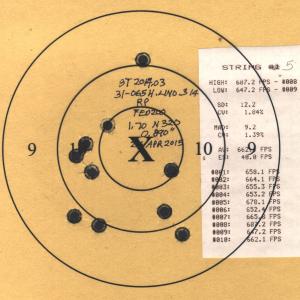

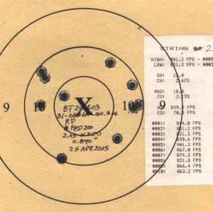

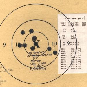

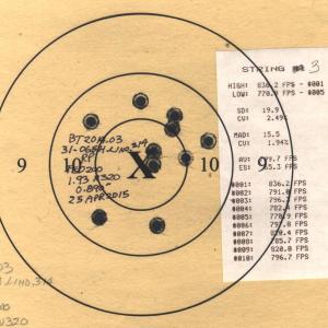

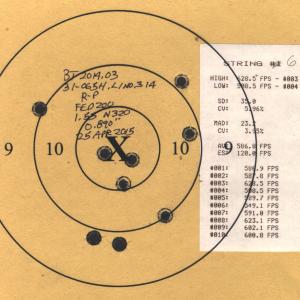

I tried VV-N320 with the Accurate 31-065H bullet cast of LinoType and sized 0.314".
The targets are attached for your reference.
Barrel is a Pardini 32 ACP mounted in a mechanical fixture. Groups are all ten shots at 50 yards.
