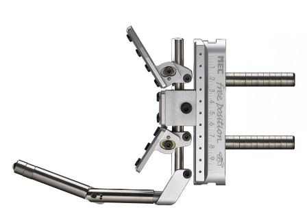

Anyone out there with the MEC buttplate that came with the integrated carrier like the one below? Where did you get it? Cost? This is the one that Walther says fits the rifle.
- MEC_plate_w_columns.jpg (13.99 KiB) Viewed 1018 times

There is no carrier in the picture. There are two rods with a threaded hole in the end and you screw it directly in the groove in the buttplate with M5 screws.
The rods is possible to buy but really expensive so I recommend you to make your own if you have knowledge and machinery or go to someone that can make them for you. They will be cheaper.
That is the system that shows in the picture and that is the way it's on KK300 I don't now if it's like that on kk200.
