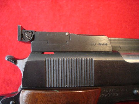

My 1911 has a bo-mar rib on it. I want to know how to you uninstall it? I can physically see three hex screws, and after I removed them, the rib is almost loose with the exception that there is one more screw around the rear sight, but I cannot find it. I took out the spring and also the elevation screw of the rear sight along with the hex screw next to the spring. I still cannot find the remaining screw that screwed the rib to the slide....
where is that remaining screw and how do I reach it to unscrew it?
Do I need to tab the pin that hold the rear sight (the adjustable part) onto the rib out in order to reach it..is it actually under the rear sight blade?
See pic, and you can see that pin...do I need to tap that pin out in order to find the last screw that screw the rib onto the slide?

That's not the sight that rib originally came with. It was retrofitted. You probably need to remove the rear sight from rib to expose the other screw. So tighten all the screws, drift out rear sight and remove all screws.

Bomar ribs didn't have dovetails for rear sight. Rib was machined for sight. This rib I'm 99% sure has been machined for a dovetailed Bomar. This rear sight was for a different pistol. Probably used to fix a rib with a damaged rear sight.
I could be mistaken but don't think so.

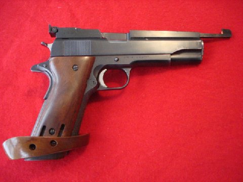

Re: UNinstall Bo-Mar Rib
Accurizing by F. Bob Chow.
- DSC07859.jpg (28.8 KiB) Viewed 4262 times

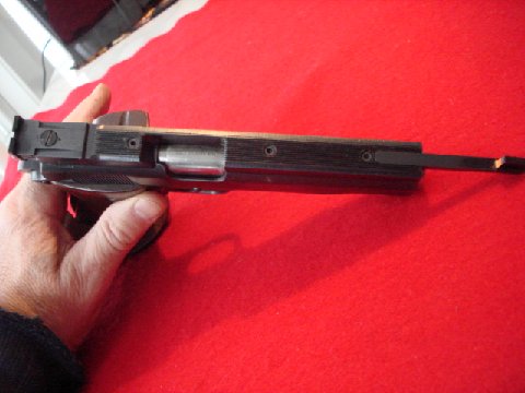

The three visible screws:
- DSC07869.jpg (28.83 KiB) Viewed 4262 times

I don't have a Bomar rib i can look at right now, but they use 4 screws. That rear sight looks like a Ruger MKII sight put on a Bomar rib.

Forgot to mention that many of the older Bomar ribs had accuracy tuners. The rear screw is at rear of rib to make room for the tuner and it's 2 screws. 6 screws total.

Definitely not a Bowmar rib. Now that we know the gun was built up by Bob Chow, it becomes evident that it was a rib built by Bob as well. The sight is exactly the same as on my Chow match gun, and while it looks like a Bowmar it is stamped as "Chow". The rib also seems to have different grooving from the typical Bowmar . I expect that ol' Bob did something devious with a fourth screw. If Bob's shop is still around- I visited it in 1979 - they are the best candidates to deal with it.

In the Gil Hebard catalogs I have, the sight pictured was the early model.
I suspect that removing the elevation screw and lifting the sight leaf may reveal some retaining screws that hold the dovetail base in position.
Slacken the retaining screws and gently drift the rear sight base off with a plastic or brass drift. A final mounting screw may be located under the sight base. Fold the sight leaf down into the slot prior to removing the base to give support to the assembly when removing with a drift.
