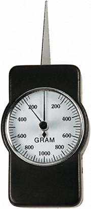

Easy way to measure 1st/2nd stages.
Analogue gram dial gauge,1000-200-1000g or bigger 2000-300-2000g.
Analogue gram dial gauge,1000-200-1000g.jpg (15.71 KiB) Viewed 1415 times

Good idea David, but the model you show is available through RS UK (Radio Spares as was) for £377! Similar devices are available from China on eBay for $50 but only up to 500g. Do you have a more economical source for the 1000g and 2000g versions?

BobGee wrote:Good idea David, but the model you show is available through RS UK (Radio Spares as was) for £377! Similar devices are available from China on eBay for $50 but only up to 500g. Do you have a more economical source for the 1000g and 2000g versions?
I bought my second-hand Correx gauges, 1000g & 2000g, on ebay a few years ago.
From memory, one was around £12 and the other around £20. One was bought from Germany and the other from Oz.
They come up on ebay every now and then, so just log a search for "Correx Gauge", and "Correx Gage" (in case it's being sold from North America).
