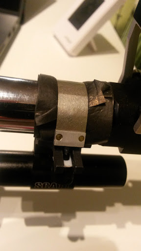

Here is how the rubber band looks like:
[attachment=0]20141126_220322 (2).jpg[/attachment]

Don't use as much padding shown. Most likely, the padding is causing the alignment problem.
However, if the alignment is consistent, you can manually adjust the POI by clicking on the shows in sighters and dragging them to the point where you call the shot. This is MUCH better than moving the sights to fix the alignment issue.
Basically, use the click and drag to fix gross errors and sight click adjustments to fix minor errors.

What happens if you remove all of that padding?
Just stick some PVC tape to the inside surface of the fixing band and sensor bracket.
Re: SCATT sensor sensitivity
If I remove the padding, it points straight, but too high, so still not in the circle. I use the padding for lowering the sensor.

Got it. I usually keep adding tape under the front half of the mounting bracket to get the angle down until the angle is correct. Back side to get the angle up.inzl wrote:If I remove the padding, it points straight, but too high, so still not in the circle. I use the padding for lowering the sensor.
