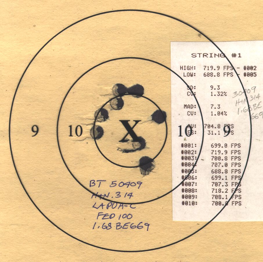

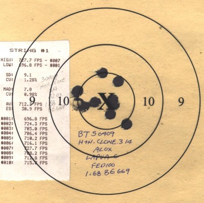

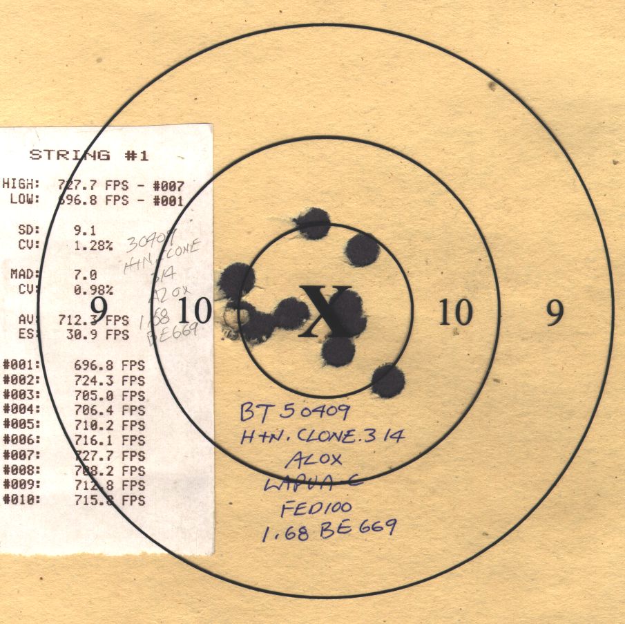

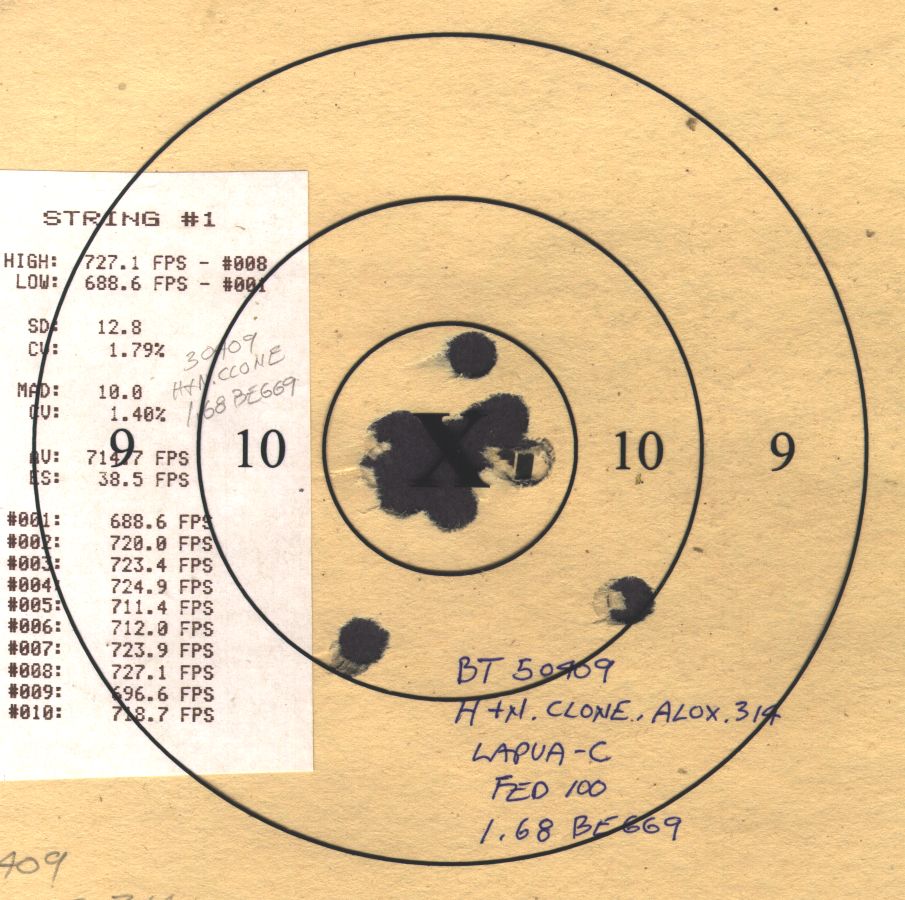

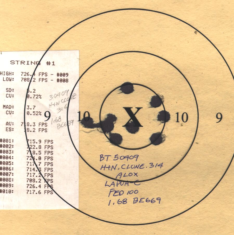

I have attached images of the home swaged bullets tested at 50 yards using my Haemmerli SP-20 barrel.
Image 0001.jpeg is the H&N 0.314 100 grain HBWC for comparison.
I have recorded the best groups in my barrels with the H&N bullets.
